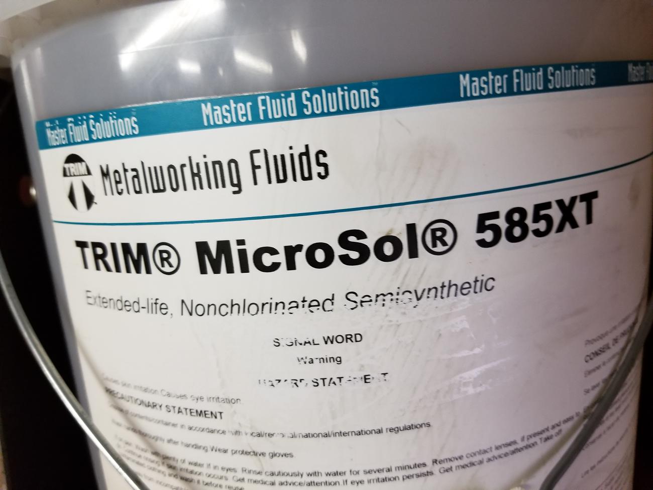

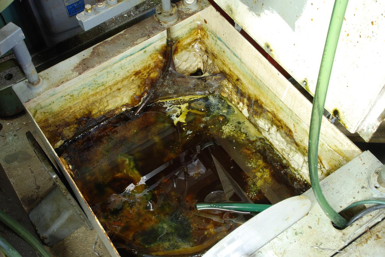

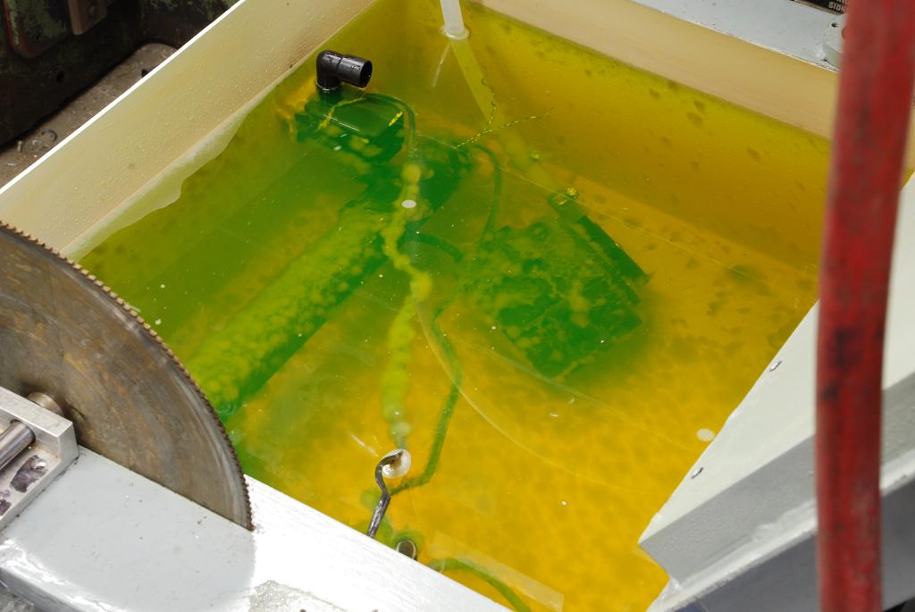

The joys of coolant (afaik unless you're using oil or air its all water soluble oil). Here's some appetizing pics ...the two different brands KBC sells. Just ends up a rotten, smelly, humongous petri dish in a few months (the oil is food for bacteria). The microsol 585, photo at the bottom otoh is great, it just doesn't seem to go bad - highly recomended. The tank btw is the Mark I "coolant server". Since scrapped, the Mark II is plasma cut and waiting in the wings for me to find time
Thanks RobinHood, now I'm not concerned about using it. I'll try different ratios and see which I prefer.
