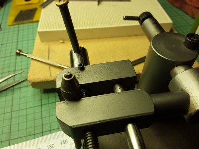

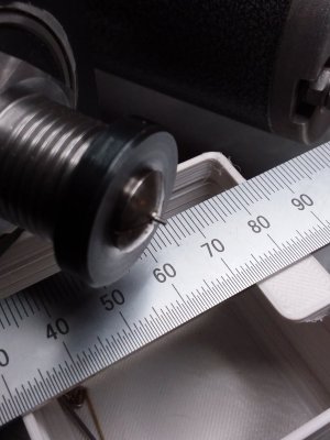

I've never really thought about getting a tiny machine, but now you have me wondering. I imagine most of the challenges of using a big 14x40 machine like mine are related to work-holding. What does a chuck for a watch stem like that look like?
8mm WW collets, from 0.1 to 5.0 in 0.1mm increments. They are like 5C, nominal size stock only. But can grip on a .75mm long feature, like the screw head.

That's impressive! I imagine that keeping stock aligned is a fairly big issue when the grip is less than a mm.
Thx, centre drills are also useless in those sizes. You have to 'pick up the centre' using a graver (special shaped 1/8" square hand held cutter). Pretty easy after one or two attempts. That gives a dimple in the centre, then you can run your 0.5mm drill in :)
I have to make a graver rest fo the Taig, you can with practice get turning to 0.01mm accuracy by hand. Steel as well as brass. Its a different world.
