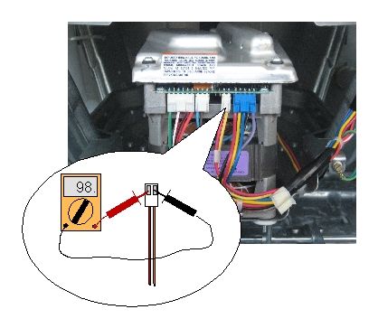

My 14 year told GE Top Loaded washer stopped agitating and spinning. The motor PCB is suppose to continously blink green if all is good but that wasn't going on. to I'm not so good with electrical and through some online guides and found no power coming from the wiring harness to the PCB. I traced the problem to the dead inline 10a 125v fuse that was blocking contuity.
I replaced this with a ceramic 240v 10a slow fuse inside an inline holder.
I plugged the machine back in and as soon as I turned it on, a bit of smoke and burnt came from the motor PCB. There is still power and contunuity to the wiring harness leading to the motor PCB so I suspect the fuse is fine.
Does anyone understand what happened? Did the PCB short because of the 240v instead of 125v fuse rating, or because it's a slow blow?

BAD idea to replace a fuse with one of a different rating. In this application, the voltage doesn't matter. It's mostly the current rating (Amps) that matters. But slow blow has the same effect as a higher amperage fuse and can also cause problems.
I got a $90k tractor for $45k because the previous owner played musical chairs with fuses. The dealer couldn't fix it. So I got a deal. I ended up redoing most of the wiring harness. My diagnosis is that a simple short in the headlamp wiring caused the fuse to blow and he got tired of replacing it and started swapping fuses. At some point a bigger fuse started melting wires buried in a harness. It didn't help that the wiring diagram for the tractor was wrong. I found that by reverse engineering the harness.
In your case, something was drawing excessive current and the fuse did its job to protect the circuit. When you installed a higher current slow blow fuse, you removed that protection and the high draw was allowed to let the magic smoke out.
You must find the high draw fault first.

I got some wrong online advice on reddit that said 240v would be fine instead of 125v since matching the 10amp is all that matters, and that I should go slow blow for a washer.
It sounds like where I am now is not worth even to replace it with a fast blow 125v 10a fuse, and I should just stop here and get a new one washer?
I don't think I have the know-how to find high draw fault as I'm clueless with electrical.

With the fuse and smoke it's likely your original controller may not be repairable. The discussion had migrated into machines not lasting more than 12 years or so. I suspect capacitors are the biggest reason since now even washing machines tend to vary the speed and are likely also 3 phase brushless motors.
