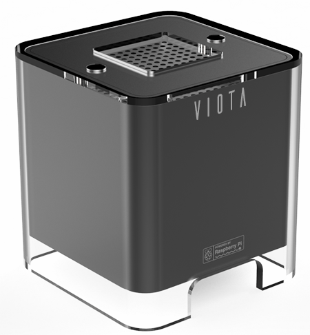

A friend of mine in the UK makes these and is waiting for the Pi5 version before he does the next crowd funding.
I already have a second MESA 7i95H that I use with a Pi3 for testing LinuxCNC ideas on my workbench.
