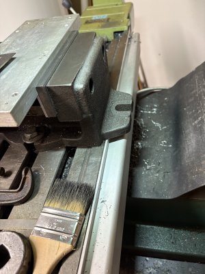

My (current?) vise has mounting tabs both on the side and the ends of the vise, see below.
Theoretically, I have about 8 inches of Y travel. Since I installed a DRO scale on the column side, that should leave me with about 7 inches usable. However, the widest piece I can mill **in the vise** is just less than 4.5 inches because the fixed jaw can't get closer to the column than about 3.5 inches. The tab on the front of the vise hits the column of the mill.
If I removed the front tab, I could install the vise using the T-slot closer to the column and gain about 1.5 inches of usable Y.
So, 2 questions:
1) What bad things will happen to my vise if I hack off the front tabs? (Probably I should just replace the vise I don't like just throwing money at every little problem.)
2) What bad things will happen if I install the vise in using the front T-slot rather than the middle one?

I can't imagine anything bad happening, except regret for not doing it sooner.? Just save the offcut for a project.
Are you certain that you gain by moving it to forward t-slot, hard to tell from photo.
The only downside to lopping that tab off is losing the ability to easily mount that vise inline with the x travel with the center slot. Ask yourself how many times you've ever done that, and how many times you might need to in the future. Then chop it off....even If you leave a little bit, like perhaps just up to the back of the slot, you can always use a toe clamp to catch what's left there anyway.

Pretty sure. Below, the table is wound out as far as possible. The spindle centre is 2.75 inches away from the fixed jaw line. The T-slots are on 2 inch spacing so moving the vise towards the column should get me more usable Y work envelope.
Below, the table is wound in until the vise contacts the column. The spindle has travelled about 7 inches but as you can see from the work piece mock up, I wasn't going to be able to square up the nearest edge.
Using the T-slot closest to the column will put the fixed jaw just about vertically above the back edge of the table. About 2 inches of the vise will be hanging off the table. I don't think this is a problem. Am I missing anything?
It occurs to me that if I make this change, I'll be using a portion of the Y lead screw that previously hasn't been worked very hard. That actually sounds like a good thing to me.

OK, I think that tab is coming off!

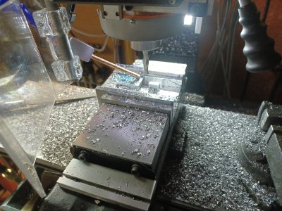

I bought this affordable 4" vise from BusyBee. It is bolted to the bed and seldom gets removed.
Very pleased with it. Easy to shift toward column for max space. Moveable jaw face can be installed on end closest to operator for holding wide parts.
