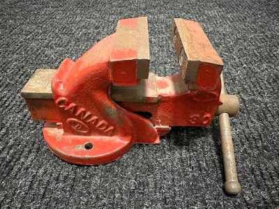

3" bench vise made by RAE (OTACO) in Orillia, ON. Claimed at times to be Canada's biggest vise manufacturer, RAE produced a lot in this size.

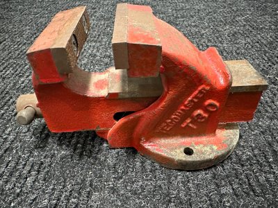

As the other side shows this isn't the usual RAE however. It was made for and sold by Eaton's under its Tecomaster brand.

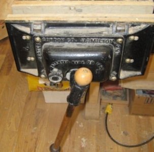

Here is my Hamilton made pattern makes vise anyway. I also have a Brown and Boggs sheet metal shear made in Hamilton.

GM Yost applied for a patent in 1907 for improvements to the Emmert patternmakers vise. Patent was granted Sept 1908, as shown on your vise. Yost advertised them in 1910, manufactured in Meadville, PA.
What is interesting about your vice though, is the name of the Hamilton company that made it: Canadian Yeates Gordon Co. An announcement in The Canadian Manufacturer in Nov 1911 shows the company based in Meadville, PA, same as Yost. It was a review type story which may be why already in 1910 Canadian Machinery ran an ad for a Yost machinist's vise from the Canadian Yeates Gordon Co., Hamilton. Also in 1911, the National Machinery & Supply Co., Hamilton, was incorporated by 5 founders including P. McC. Yeates. Later in 1911 another ad appeared in Canadian Machinery for the Yost machinist's vise, with two key differences: the company running the ad was National, not Yeates Gordon, and the vise is now said to be made in Canada. Then in 1913 an entry in Canadian Machinery makes it clear that National was Yeates Gordon. There are vises around which look like yours except for that name change.
Your vise, while desirable as one of a limited number of patternmakers vises, is also quite rare as it appears to have been produced for only 1 or 2 years.
. 1911-11 Canadian Manufacturer p48 established.jpg 1910-12 Canadian Machinery p24 Yost vise by CY-G.jpg 1911-05 Canadian Manufacturer p44 incorporation.jpg 1913-01-30 Canadian Machinery p85 name change.jpg 1913-01-30 Canadian Machinery p86 name change.jpg
The first print mention I have found of the Yost patternmakers vise being made in Hamilton is from 1915, in an announcement about a National Machinery & Supply Co. Ltd. catalogue (which I would love to see!). National calls the vise the "Universal" woodworkers vise. In 1916, an illustration. Finally, in 1921, the last mention, because months later the company was bankrupt.

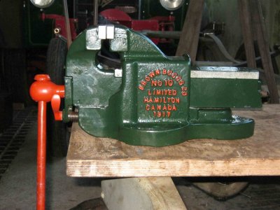

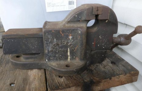

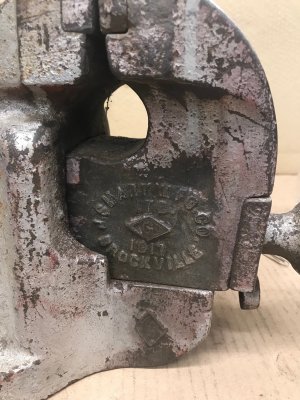

As you said earlier, Hamilton had a thriving industry. Brown-Boggs is known for their bigger machinery, but they also made an oval slide vise (have never seen one), and a very nice iron workers vise with quick release. Great vise, and what really intrigues me is the "1917" marking. I've seen similar style vises with that marking from James Smart in Brockville, and from Rock Island in the USA. Seems to be related to WWI war production but haven't found exactly what the arrangement was as yet.
1912 B-B No3 Oval slide vise p122.jpg 2021-12 Brown Boggs No10 GJ.jpg 1918-03-09 Hardware and Metal p65 quick acting vise No 10 others.jpg
Smart 25 2023-12 kijiji KingCity $80 03.jpg z 1917 Rock Island GJ 01 like Record 22.jpg z 1920 Rock Island catalog p244 Quick-Acting.jpg

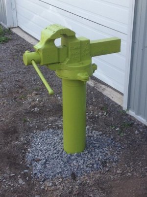

This is my Clark Machine vise. Made in Thorold about 10 minutes from me. Been in business since about 1922View attachment 69394View attachment 69395
Thanks Martin, for the greeting and the pic. I like Clark Machine vises.

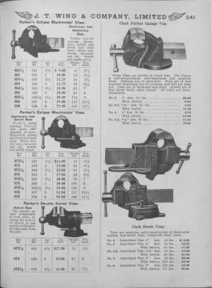

They were in Galt before moving to the Niagara area in 1923. No evidence they made vises in Galt. Yours would be an earlier one from Thorold, before they moved to Merritton. Vise production ceased sometime in the 1940s according to a local history article; listed making them as late as 1950 in a manufacturer's directory. Still around today I believe as CMI Heavy Industries.
I've seen a 4M, 5M, and 5M-S with swivel base from Merritton, but the only vise in that style from Thorold that I've seen is marked M6. There should be some other sizes around according to this 1938 catalog.
Does yours have a number on it, or can you tell me the jaw width? Thanks.
1930 History of the Niagara peninsula and the new Welland canal by A E Coombs.jpg 2012-12 Merritton Matters by Phyllis Thomson.jpg 2018 Fort Erie because p48-49 profile.jpg
