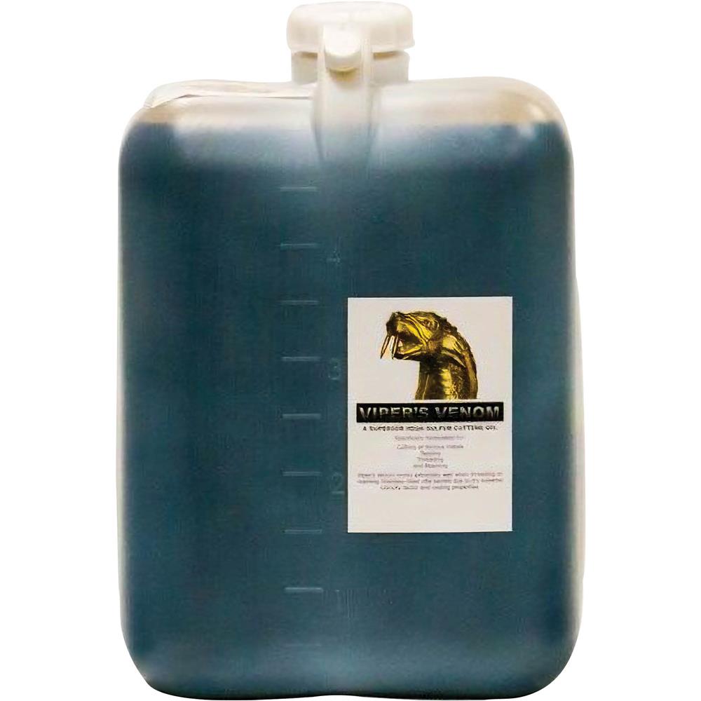

Grizzly sells it in bulk volumes as well as bottles.
Buying a 5gallon pail, and redistributing it in smaller quantities seems like a good little winter side project for a semi retired farmer in the off season.......
I'd do that in a heart beat if I could get the 5 gal pail. But I can't get it across the border. This whole discussion would be over if I could.

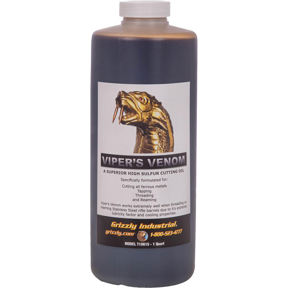

I ordered 1 quart of Vipers Venom from Grizzly. I fully expected that my order would get rejected. Instead I got a shipping date and a tracking number with UPS.
A week ago or so, I got an invoice for shipping, handling, and customs. I paid that electronically.
Today, this arrived - undamaged and sitting right side up.
On the strength of how well this trip went, I'll order a 5 gallon pail as soon as Grizzly has stock. Then I'll make some available to members who want some.
For anyone who might be interested, venom is a high sulphur cutting oil for ferrous materials. What makes it special is its stickiness and slinging qualities. You put a drop on the work, and it spreads out and sticks to the steel. One drop is good for 2 or 3 passes. It's great stuff, best I've ever used.

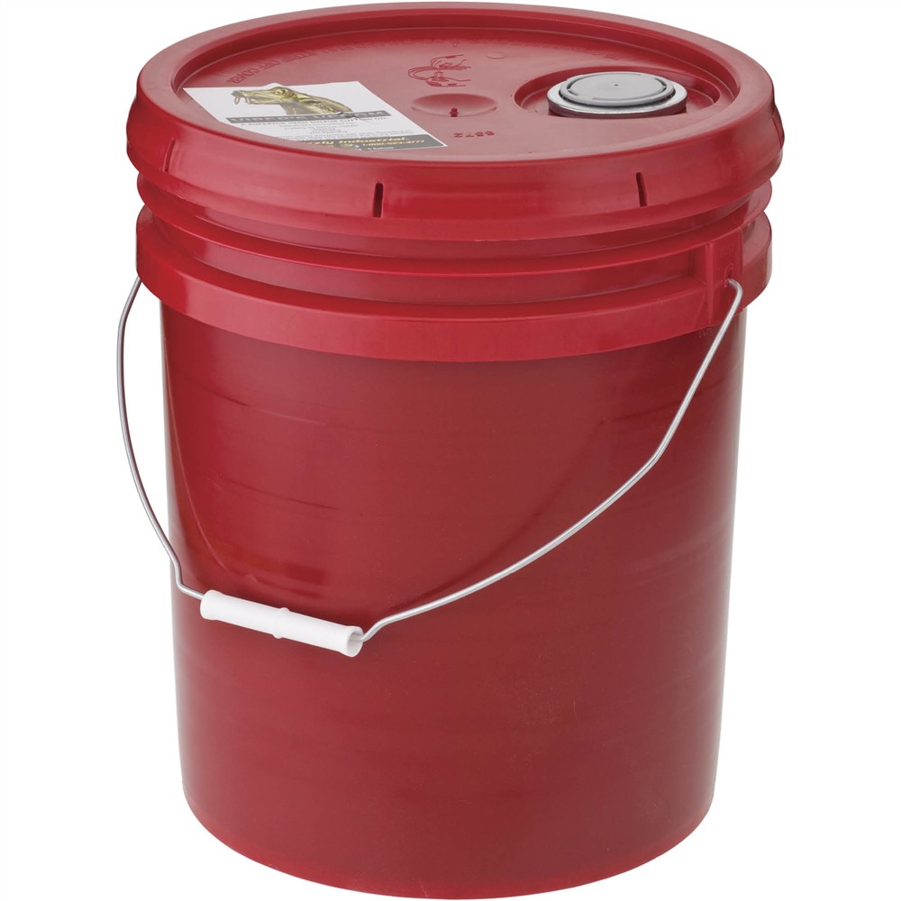

I decided to order a 5 gal pail and take the tarriff risk anyway.
Grizzly cost was 320 + 50 shipping and I got a $16 discount. So USD 354 from Grizzly.
I'll provide another update when I know what the taxes, tarriffs, and UPS fees are.

It has landed. I now have a 5 gal jug of Viper's Venom in stock.
Total delivered cost was:
Original purchase $319.99 US plus $50US shipping is $369.99US. The charge on my credit card was $522.63 Cdn
As expected, there were also UPS Charges including duty and taxes and brokerage fees
Taxes & Duty - $59.68
Brokerage Fees - 47.63
All in, my cost was 629.94 say $630 Cdn in round numbers. In portions, that turns out to be:
