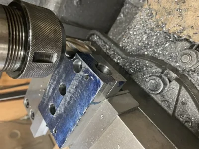

These are the plans for the Utilathe taper attachment as fitted. They are close to the original as possible and should fit the 9 and 10 inch modle and possibly the 12 innch LD Utilathe. I am not certain on the 11 and 13 inch as they changed the style completely. Some of the drawings I will update as the layout is not the greatest.
Here are some pictures of an original assembly:
The plans are attached. I will see if I can clean things up and also attach the autoCad .DWG
