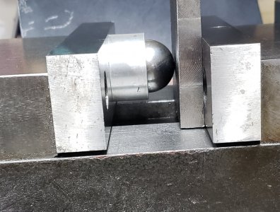

Doing it the normal way for me is to use a ball bearing. I get them from airplane propellers so they are abundant and free for me.

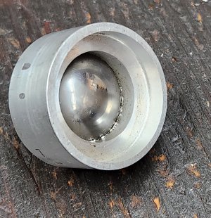

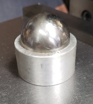

It's just a 1" ball bearing, and forced fit into a piece of 1.5" diameter aluminium cut off, that was bored out.

Thanks as always Stel. I'll be making one of those for myself as soon as I find a suitable ball bearing.
Balls I've seen in the past for this purpose didn't have the aluminium sleeve. But most did have a handle drilled and tapped into the ball. You could consider adding one to your sleeve just cuz it's easy to do, but I don't think it would really add much cuz your contraption is pretty easy to hold as is and who needs yet another handle taking up space in the tool drawer!

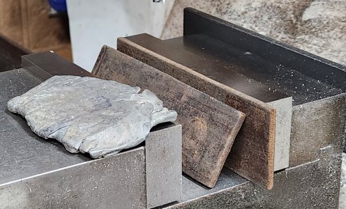

I like MDF or fiberboard. Mostly because I always have offcuts handy in many thicknesses: 1/8, 1/4, 3/8.... Its hard enough to be a decent clamping surface, but soft enough to conform to irregularities. And its amazingly equal in thickness even though that's not what is being asked of it in this case, it makes for a good spoil board that you can CA or epoxy parts to, or drill through. But another feature is it offers a lot of 'stiction' between part & jaw. It does not do well with liquid (cutting fluid & certainly no coolant) because swells.
if I have one minor beef about ball style, it only offers a tiny bit of contact area. Good for conforming to an irregularity, but not quite as good grip for irregular or rough milling which is more than likely what is going on at this stage. Yes you can crank it, but no you can't always crank it on delicate parts.
I tried solder on a stack-up of (so called) identical parts to mill across them all. It seemed to work. You could see some irregular flattening. But it was the erratic milling action that loosened them & then bad things can happen. Plus solder is getting damn expensive.
I also use thick leather for more delicate stuff, and sheet lead for the really rough stuff.

I'd rather use something that has some give to it, and that can conform to the work's surface, than use a single point of pressure, as you get from a ball bearing.
So, I guess, I am pretty much on side with leather, wood, soft Al Weld rod, and a bunch of other stuff, but not so much, the ball bearing with a single (indented!) point of contact!
The big ol' ball bearing is nice and all, but I would about as soon use checkered vise jaws on my work, as use one to square up a part. My goal is to make parts that nobody can see how I held them...

@Degen @trevj I understand your concerns, and I agree, but you wouldn't use the ball bearing on a finished surface, unless you protected that surface with a metal pad. The OP was specifically asking about squaring up rough stock.

Well that's the whole point here. This is not a finished surface. The whole thread is about rough stock not finished material. So there is no worry at all about a ball deforming the surface. Any deformation will get machined away in subsequent steps. I kinda like the ball method and plan to make something similar.

Forgot to say, the advantage of the stehl's bearing ball is it has a flat surface on moving jaw which is kinder to the jaw & more aligned to screw. It can be positioned middle-ish of the jaw which is also good. Because even if you have a couple thou top view taper, is not a great loading situation for the vise jaw. If its very rigid, it will just be a point/line contact on the part. If its less meaty, it stresses the jaw trying to conform. Something firmy-squishy mitigates most of these issues & usually has added grip. Just an opinion from an amateur part propulsion enthusiast.
