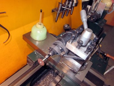

Just another idea for you. I don't often use it but it does ok, and I have a variable speed box I can use on it also
So that arbor `extender' on the cutout tool -- is it an off the shelf item? I can fit a 1/4 inch collet in my drywall tool but extending that much mass out that far would not be my first thought . . . If it fits over the collet nut thread, that would be better. Then grind the collet end to centre. If you had a tiny grinder setup ;-)

It is a model DW660 and has a plastic skirt to vary the depth. I removed that and used it as a pattern for the holes in the mount plate. With the skirt taken off the extension is there as is. It now costs 125 bux at Cantire
Ah, I see. My drywall cutout is older, with no skirt so the collet nut almost meets the front bearing housing -- no shaft stick out to speak of. Thanks for the tip.
Did you actually build that specific Dewalt version? I've had that one on my list for a long time. Between the top of the list and the end. It's not #42 but close.
Yes, I built it using what I posted. It works fine, but I have not had luck in finding someplace stocking good stones lately. They all are mainly for hand held air gringers and are too course. It is in my lathe stuff and I have not used it in quite a while, I have not had jobs that needed grinding. Every now and then I see a real post grinder and want it, but I manage to talk myself out of buying.
All I can find is this photo. No idea where the rest of the drawings are. I know I had more photos and the drawings.
I can send you what I have and some photos of my build if you send me an email. I found I had to change the mount a bit when I changed my QCTP to a C size.
