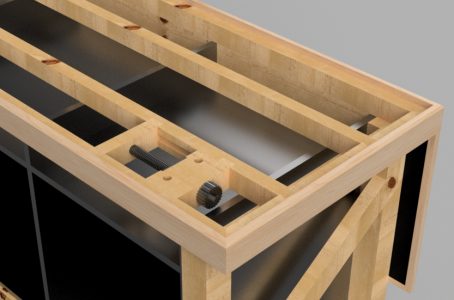

So I have resigned myself to the fact that I wont get to maintain a clear workbench. I have been able to maintain an open space on the first 10" depth or so, and figured that I can use that to my advantage.
I occasionally need to clamp items especially boards to my workbench so I designed a tail vise that is totally unobtrusive when not in use. The access hole and the dog holes will all have plugs inserted when not in use as well.
Two rows of dog holes and a vise with a sliding block under the MDF top that has two dog holes makes it pretty versatile and secure.

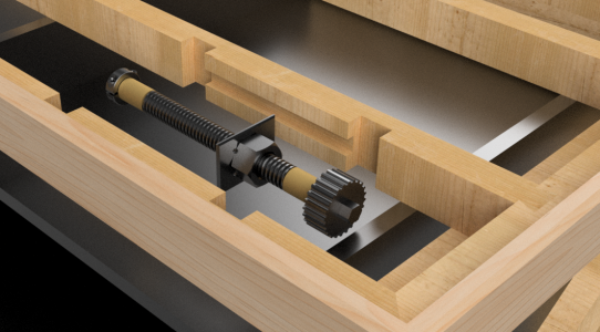

The parts are a 1" acme screw and corresponding hex nut, two 1" - 3/4" bushings 1 1/2" long, a 3/4" shaft collar, a nut retention plate, and a knob with a 3/4" bore. The acme screw will get turned down to 3/4" dia x 1 1/2" at the far end, and 3/4" diameter x 1 1/2" and 5/8" by 1/2" hex on the other end.

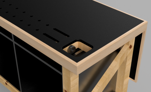

The tightening the vise will be accomplished via an access hole in the work surface and either a small hand wheel or a 5/8" ratcheting box wrench. I'm debating making the access even smaller to only accommodate the box wrench. The total vise movement is 5 1/2" which is well over the 3.78" dog holecenter to center distance.
Turning the screw moves the vise block, and the inserted dogs.
Very cool design. Here in the states we refer to those as a "wagon vise" and they are all the rage on Roubo type workbenches. Benchcrafted makes some (expensive) hardware for them.

Yeah, I don't get why they're also called wagon vises. I saw bench crafted version $$$. This version can be made with 1" threaded rod and a nut for under $50. I've got a short acme screw sitting going to waste so it will only cost me my time and a few scrap pieces.

Yeah not sure about the wagon vise name either. Benchcrafted likes to act like everything is special but there are those of us who crossover from woodworking to machining who understand there's not a ton special about them. But in the woodworking only guy world you literally cannot replicate what Benchcrafted does - even though they're actually selling something not overly expensive for top dollar.
Just a quick thumb through McMaster shows I can purchase the nut and lead screw for way less than half of what they want for the vise - the rest is a simple handle and easy parts. A better made one is done by (Canadian!) Rob Cosman - who uses a 1 1/2 double start acme rod instead of a 1 1/4 one - though recently he switched from a bronze nut to a brass one.
A 1 1/2" - 4 double start from McMaster is 76 bucks and a bronze nut to match that could be used for either a shoulder or wagon vise is 135. So setting aside the ability to make these (I'd probably make the nut to ensure fit). A quick look finds a suitable length class 2G acme rod is around 100 so there goes the "so special rolled thread" part of it. Either way anybody with the necessary desire could make something much higher quality for much less money.

But as you say, they parts are super cheap, and they can be made without any machining experience at all using 1"-8 threaded rod and a nut. We have a much easier to access supplier in Canada. For comparison tryhard industrial 1-8 threaded rod and nut, plus lock collar and two bushings would only cost $24. With another $2 hex nut, a drill, grub screw and some epoxy you can make a handwheel...
