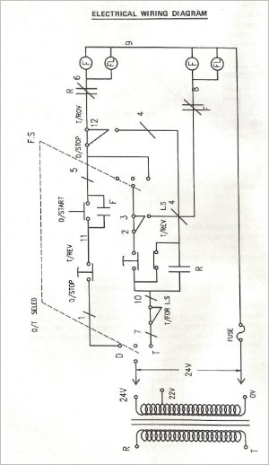

Any idea of what these connections go to ? And how to find out ?
l'm Looking to be able to learn about wiring the motor on my RongFu-45 mill/drill . I bought a couple of well used Taiwanese machines, a DF1224g lathe and the RF-45 . Just $1700 for the pair. Used RF-45s were going for at least $1500 at the time. . Obviously, they had problems, both had mickey mouse electrical repairs. The lathe got a Baldor 3phase 2hp and a Hitachi VFD . I'll use the mag starter off the lathe and a SquareD drum switch for reversing. Both are 2hp rated. The motor is a " Capacitor AC Induction Motor" 2hp 1ph 1725rpm 10.5amp 2001 date. I have 220volts.
I'm a 73 old retired millwright and am willing to learn something new. At my age it's pretty slow learning, though, chuckle. Not like half a century ago. Once you understand something, it's simple .I ,then, can follow a schematic . I know single phase motors work start with starting windings and have run windings . BTW computers are not on my list of skill sets, so I'll just have to list the input wire colours and pins with their motor wire numbers on the junction box six pin block.
top row
white- #6
yellow-#1
----- #5#3#2 connected together
bottom row
red-#4
not used
black- no number
What do these wire numbers go to? These were on the inside of the lid.
There is a circuit breaker. I wonder what it connects between ?

On another forum, I got the information pins 1 and 6 are switched for direction change . pin 4 is a constant. He also provided a schematic for use with my drum switch.
The SquareD drum switch I purchased at Princess Auto is a 2601 model. I've learned it's a "chopstick style" . Basically a 3phase unit. There is "hockey stick style" of drum switch, too. .
This morning I taped off the power leads from my contactor and plugged in. The power on light came on . It is supposed to be switched along with the main power. I see some quality time with my multimeter today tracing connections. oh well.

Today's time with the multimeter has shown the use of the contactor that I took off when I did the lathe conversion, is not going to be simple. It's going to take some wiring changes. It's do-able . Luckily, it's pretty crude, it came off a' 92 Busy Bee lathe. But, hey, I'm learning something new.

I think I sorted out the motor control wiring. Before installing, I tested the motor by hooking up the motor to a switched leads using pin # 4 as a constant and changing #1 and #6 and only got a hum on either set up. . So I took the motor off . Someone had been here before me., they used copper Nerv-Sieze. Time to take it to motor repair shop. Motor rebuilding is beyond my skill level.

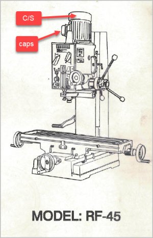

@Downwindtracker2 I had an RF-45, single phase, 220V (1998-ish vintage). The manual isn't exactly what I'd call rich with electrical information but here you go FWIW. I also know that later RF-45's (both Taiwan & then China made) had quite different wiring & controls, so this may be of zero value. Saying RF-45 is like saying 'car'.
One thing I haven't heard you mention are the start/run capacitors or centrifugal switch. I never had issues with mine so never went digging, but that is a very common area for things to go wrong with these kinds of motors & machines. A hum or cogging sound may be a symptom, but not necessarily so. Smarter electrical people than me on the forum can guide you how to test. I suspect the centrifugal switch is under the motor end bell cap. My parts sheet doesn't show anything in this regard, but logically that's where it would be.
