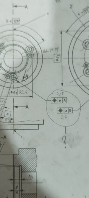

So I'm planning trying to build my own D1-4 back plate for a 4 jaw chuck I've had laying around for ever. So I decided to fool around with layout with DRO whole I wait for my collets to show up. My DRO is only 2 axis but it does have a bolt hole circle function which is great makes making the 3 cam lock pins holes much easier but I'm not sure how how to lay out the retainer cap screws using the DRO with out manually zeroing each hole and using the bolt hole circle function to index each cap screws hole was hoping to lay out everything from central point to help with any errors. Probly not needed but would like to learn how to maintain accuracy and consistency. (I don't own rotary table yet so indexing with DRO is currently best method for me atm)
I also don't understand fully what the blueprint detail I've circled in attach picture is referencing. From what I found on symbol syllabus that bullseye means position but not sure what position that really means in conjunction to the information it's provided.
I've attached the prints I will be working off to make it easier to follow along with my question and possible more questions if I run across something along the way. I would appreciate some advice and look forward to learning more.

Your drawing is just cutting it off but almost looks like the retainer hole is stepped offset relative to that angle (15-deg ++) of the pin hole, which is at some centered diameter. Personally I would dial the plate to the center hole 0,0 & (spot/drill/ream) them all using X,Y coordinates relative to center in the same setup. Minimizes errors IMO. Many of us have tools to make you a dimensioned CAD drawing to whatever number of significant figures you like with the appropriate information in hand. Sorry I don't know what the symbols mean, counterbore head clearance maybe? I had some very detailed camlock drawings at some point but they are MIA. I think it came from some kind of spindle summary, not a chuck provider.
phaxtris
(Ryan)
Looks like to me that "O w A" is giving you the tolerance of d1 In detail/cut A-A and O x B is giving you the tolerance for location of the larger of those two holes, marked B in detail/cut B-B
The table with the tolerances is on the next page in that document
I agree. That was my take too. But you are faster than I am. No corrections from me!
Peter, download the pdf in the link. It has the full drawing in it.
Phaxtrix beat me to the interpretation, but I like your suggestion better than what is in the drawings and specs. Never let the perfect be the enemy of the good.
Also, the download is a great source for the data you lost. I've added it to my files for that reason too.
Aha, how did I miss that. Good document.
In another discussion someone downloaded a solid model & apparently it checked out to official dimensions (random example). But I am loathe to recommend this. I've also seen some other stuff that was complete garbage.
justin1
Thanks for the info on what the symbol means I was confused on what they meant. That link @curmudgeon did a great job as clearing up anything I had about that.

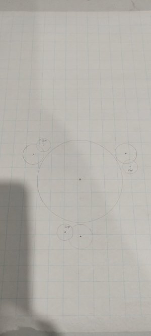

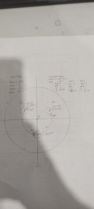

So I have attached drawing of what I'm currently doing to find all 6 holes on DRO. Makes sense to me but may not to everyone lol... But there has to be way to find circumference of the cap screws holes from the plans I have. But I feel like I'm missing a measurement to find it. Would be lot easier to use just the one center for both layouts.
Radius- ??
(No where on drawing mentions this for cap screws from center of workpiece that I've seen on the 11mm from center of main holes)
Holes- 3
(Easy to figure this one out)
Alpha- 0???
(Not sure what this does yet)
Beta- 90° + 15.01°
(rotates holes I figured out.)
Update:
Actually currently trying to figure out Irregular Triangle trig stuff think I can find the radius with math... Yeay fun a subject I did very poorly on lol

I'll take a stab at this, and am very ready to learn I did it wrong...
Starting at your bottom stud, you located it at (0, -41.3).
The adjacent cam is 11.0 mm away @ 15° 36' or (15 + 36/60 = 15.6)°
The y offset is sin(15.6°) * 11 mm= 2.96 mm
The x offset is cos(15.6°) * 11 mm = 10.59 mm
So that cam would be located at (-10.59, -38.34)
I can continue on to calculate radius and other positions if you want.

Don't have a clue how you got this numbers like witch craft too me is there a resource to do what you did? I got about this far(attached picture) with the trig stuff before realizing I don't know how the alpha beta stuff works with the letters and would solve what I thought was c and then use that to find angles of 2 missing sides just to get errors lol...
I let the DRO do that math for the first 3 holes I just used what was on drawing and input into dro lol so was trying to find the other radius and let DRO do hard part
Edit: noticed I screwed up on degree when I transferred data to drawing I wrote 36" not 36'

If I understand this right my other cap screws should be at
X+46.355
Y-17.69
X-25.175
Y+23.61
X-10.59
Y-38.34

In your sketch, it looks like you're trying to calculate the radius of the cam hole centres
You have 2 options to calculate the length of that leg of the triangle.
1) use Pythagorean Theorem, i.e. a2 + b2 = c2 where a and b are the lengths of the legs of a right-angle triangle and c is the length of the hypotenuse, so (41.3)2 - (11)2 = 1,584.69; take the square root and the length of the missing leg is 39.8
or
2) use trig, you know the length of the hypotenuse (41.3 mm), and you know the angle (15.6); the cosine of an angle is defined as the ratio of the length of the adjacent leg / length of the hypotenuse; so cos(15.6) = r/41.3, and r = cos(15.6) * 41.3 = 39.8

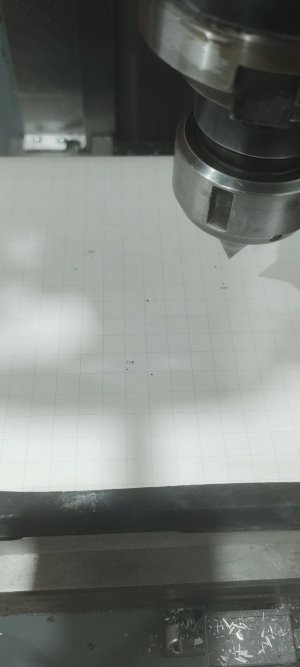

Ye that's what I was trying to do but ended up with 30.08073 sooo I was doing something wrong for sure. Going to have to study up on how that works because I don't have a clue what hypotenuse means or how the sin cos tan work. I tried to follow along with a video but kept getting different answers. Then tried those online calcs but they kept giving me 2 different options. The only advanced math thing I use is the 3/4/5 method everything else is usually done for me on the blueprints or if field fitting something cardboard and various other tricks to make things work with out math :(
I used the 39.8 with the DRO and
Radius: 39.8
Holes: 3
Alpha: 0
Beta: 105.6°
And that seemed to work I think? Looks correct lol if that means anything.

That's really cool that you can use the DRO to mark out your layout like that. If each pair of centres measure 11 mm apart then it looks like you nailed it; nice!
