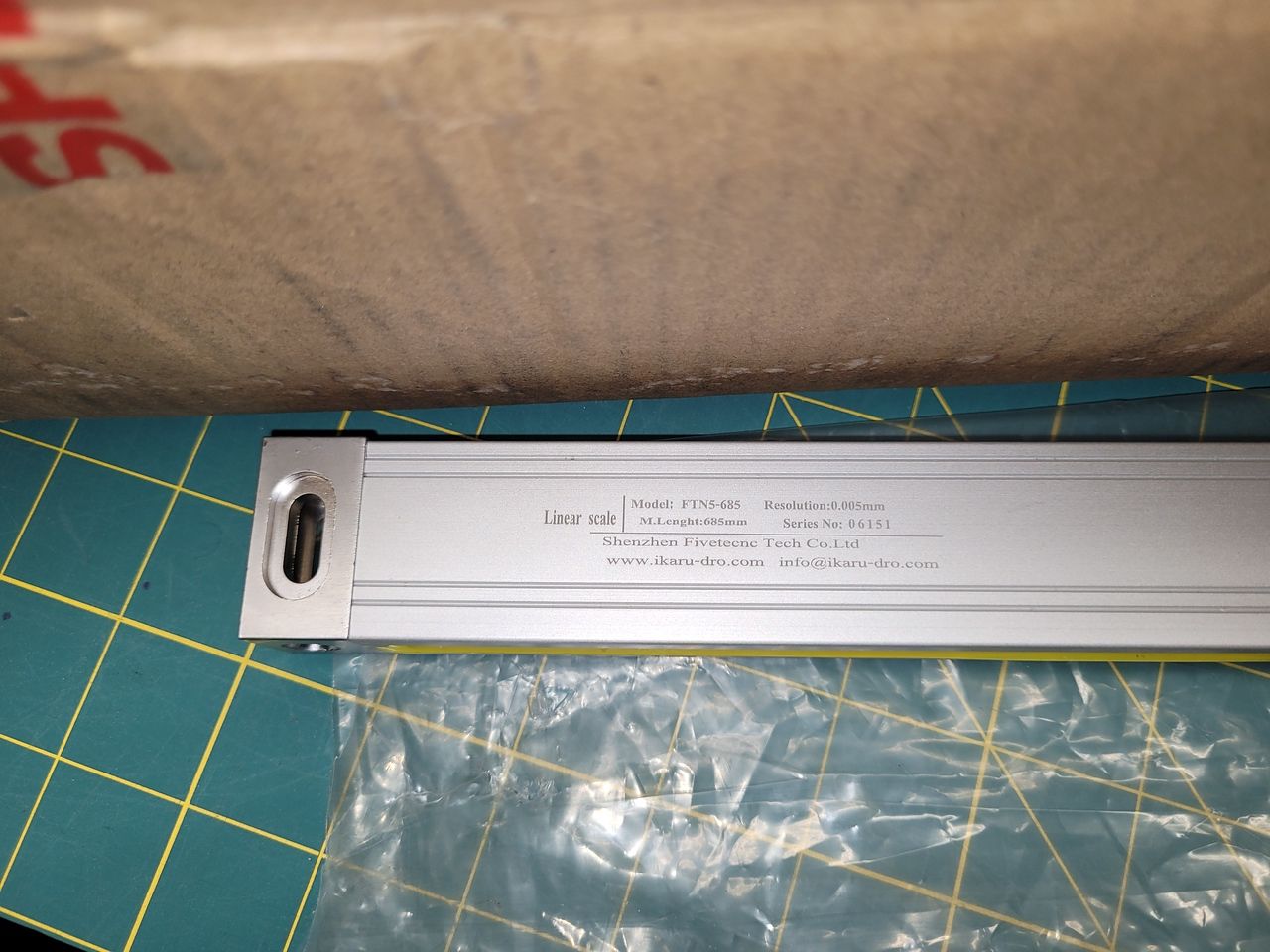

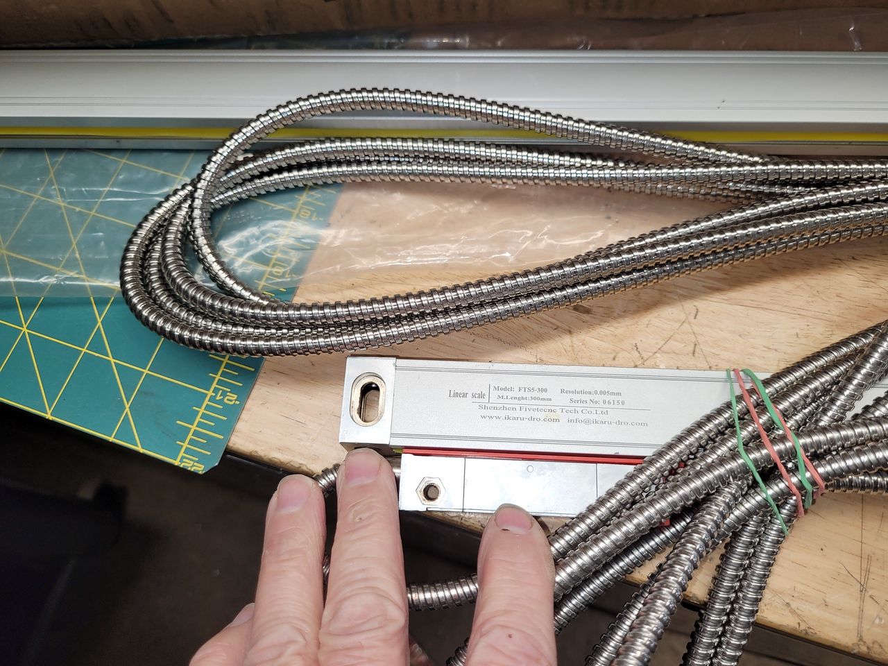

A friend of mine has a 12" X 36" lathe. When he ordered his DRO kit he ordered the wrong length of scales. The short scale for the cross slide is 300mm(11.8") total length and the available travel is 180mm(7") so would be suitable for a lathe with less than 7" of cross slide travel. It is a "slim" scale with an end profile of 19mm X 28mm. The long scale (20mm X 32mm end profile) is 685mm(26.9") total length with 560mm(22") of travel so it would be suitable for a lathe with carriage travel less than 22"
These are generic 5 micron resolution (.005mm or .0002") glass scales.
Asking $100-(We just ordered the correct length scales for his lathe at a cost of $260)
