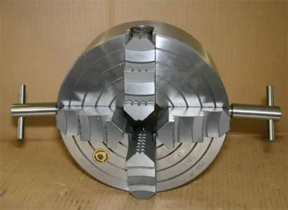

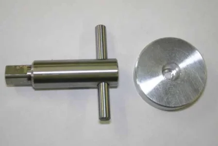

Twin 4J chuck keys
I made a pair of identical chuck keys specifically for setting up my 4-jaw chuck. Not my idea, I saw it somewhere. But it works quite well because you can adjust the opposing jaws simultaneously in unison while watching the dial & just converge on the target with both jaws tight. Its easier to do than explain but saved me set dial-in time because normally I am slow as a tortoise.

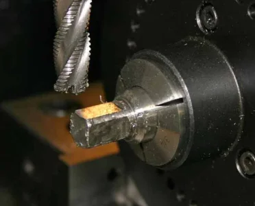

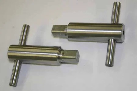

I found a piece of mystery metal that was 0.750" & shiny - always a dangerous sign :) It wasn't magnetic so I knew it was stainless. But this was some weird, tough sh*t for some reason. Long, hot, curly, razor sharp swarf came off at the lathe. Turning, drilling, milling & tapping the stuff was just brutal compared to mild steel & fighting me every step. It seemed much tougher than any stainless I've tried before. Hey is titanium non-magnetic? DOH! Oh well, used up the scrap & it wont rust. Initially I was going to make a knob but didn't like how it looked so went the tommy bar route.

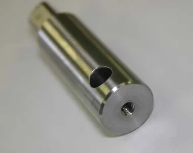

Notice my goof up, the tommy bar is not aligned to the square facets. Oops. Then I looked at my other commercial chuck keys - neither are they! Haha. So its a design enhancement, not a screw up.

John, yes Bison 8". Bought in '99 or so for a whopping $400-ish at the timed. I should have bought a pallet & stored them like gold bars, now they are 3X that. If you're in the market for euro chuck tooling, I see KBC is now carrying TMX (Toolmex), they recently had 30% off intro sale. I've never figured out the Toolmex/Bison relationship but supposedly is same specs, also Poland? but different marketing... anyways less $ than Bison brand.
Alex - just kidding, its stainless for sure, but I don't recall ever knowing the alloy or even where I got it. I think I had a similar experience with it before which is probably why its been at the bottom of the box with 'X' on it. :) The valves on my radial are also SS so I was apprehensive about using it. But the few testers I made from 416 turned out quite nice, even 303 easier to machine.

I need to make like 4 chuck keys - almost all my keys are to short and I have hard time moving them when they hit back side of the lathe with handles.
Stainless is hard to work with - just as 4340.
Toolmex is supposedly distributor for Bison. Bison is expensive even in Poland - so no chance of getting it at the source for less.

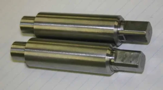

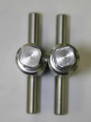

Another set, this time for my little 5" Gator 4 jaw chuck. The mystery stainless I used on my other set was a bugger to machine but I wanted to use it up on something relatively simple. I didn't have the right diameter so this time I used some O1 drill rod for no particular reason. Its tough stuff too & was handy. I might heat treat the ends just for kicks but it probably isn't necessary. Some chuck key leanings to pass on if you decide to make yourself a set.
- I couldn't really figure out why the progressive necked down diameters on the stock key. I thought maybe it fit another scroll chucks where that was required but oddly I also have a 5" Gator 3J and it uses a different key. Maybe its a generic key design & they just scaled it? If you can think of a reason let me know. Anyways I kept mine simpler with just a short reduced round section which forms the boss of the 4 milled key facets. Notice the underside of the jaws has a curved recess so the 0.5" stock easily fits in there.
- I wanted these to be stubby so I could get on either side of the chuck. That's the whole idea is being able to turn them in opposition to dial in a setting simultaneously without going back & forth on either side with a single key. But on a RT its also possible to bump into other things so I stayed with my short Tommy bar handle retained by a set screw. So you can cinch them down pretty good or remove the tommy bar or locate off to one side, whatever the situation calls for.
- I made my first one copying the square dimension of the original key. I was only a couple thou off but it wasn't the best fit. I rechecked the original, also not a great fit. Guess I never noticed till now. Then I got the bright idea to actually measure the chuck female square. I tweaked the dimension & increased the size, they engage much better now.
- O1 machines decent enough but I noticed in tapping, especially fine threads, the typical recommended pilot drill size (what is the number again 77% thread engagement?) can be a bit tight. So sharp taps, lots of oil, yada-yada. Since in this case its just to hold a non critical set screw, it would have been smarter to go up one numbered drill size. You lose very little in terms of thread engagement but tapping is usually less drama. I have to remind myself of this all too often. I think I'm going to make a little chart for common tap sizes. If it loos useful I'll post it.

Please make that chart. I always end up drilling and then drilling 1/32 larger every time. Gets kind of annoying.
Nice keys BTB. Need to make a stubby set myself. Mini Lathes and 4JS are a PITA space wise.
