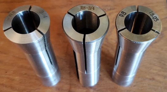

I ordered this set of tool holders back on September 3rd.
Total price for me was about $90. The R8 Chuck is garbage with an unloaded ID of 0.7400". The holders require pressure to insert and leave marks on the TTS tool holders.
Compared to the one I bought many years ago from The Little Machine Shop which has an ID of 0.7505" (Marked 19.05mm) and the holders slip and can be removed easily. The one on the left in the photo is a standard R8 3/4" collet and measures unloaded at 0.7480". It's a bit tight but still way better than the one I received.

In my experience the Chinese TTS holders aren't particularly hard. Just chuck a long 3/8-inch dowel pin in your chuck, grip the end of the dowel pin in an ER20 collet held in the TTS holder and bevel with carbide lathe tool. It only takes a few seconds.
I'll give that a try.
