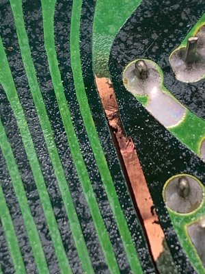

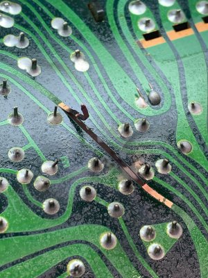

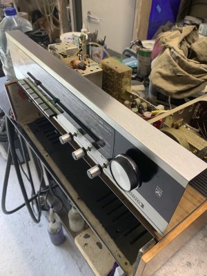

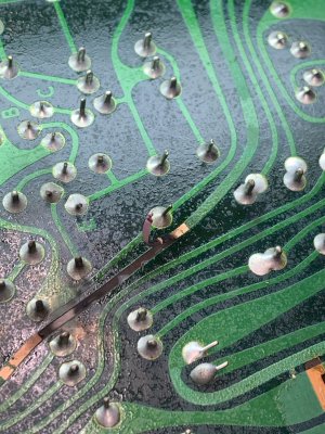

I p/u this Grundig AM/FM shortwave radio from the 70's and I'm not sure how to proceed.
Has anyone found a method of repair to fix a break like this?

carefully sand off some of the varnish off back where the trace is good on both ends and solder in a wire to replace the trace
alternatively you could follow the trace all the way back to the component on each end and solder a wire to completely replace the trace, a solid 18 or 20g would be more that adequate
The placement of some traces can be important, especially in a RF design, I think you are better off placing a wire over the burnt area. Obviously the fault needs to be determined and corrected first.
i would agree, when i have done this i bend up a piece of wire to follow the existing trace
