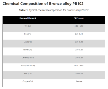

PB 102 is a wrought phosphor bronze. It contains no lead or zinc, just copper, tin and a bit of phosphorous. It is excellent for silver soldering and brazing. However it is difficult to machine (20-25% of free machining brass). It is supplied in rounds, square, hexagon, flat, strip, etc. Not all suppliers have every type.
well... maybe a little 🙂

Peter: Those lead zinc numbers are trace or zero unless you need some special ultra pure lab or scientific metal. Maybe, at today's prices if you want to buy a ton of it they will make a special run but otherwise forget it.
