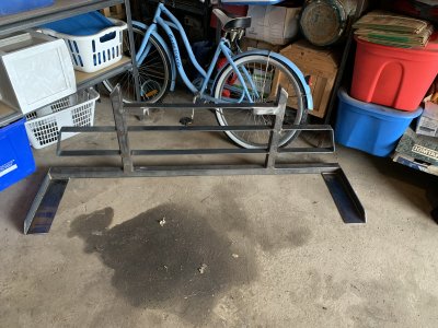

So welding projects in between machining and wood projects. Middle boy has new truck and needed a back rack for the times he carries a ladder. The new trucks didn’t have a back rack that properly spans the rear brake and truck bed lights. I fabbed one up with over kill 2” x2” x 1/8” tubing and 2” x 1/4” flat bar.
I measured off the uprights for the side angle parts. My welding table has 3/4” peg holes so I made up a couple pegs and one peg that I welded to the table. Heat with torch and bend carefully around the pegs:
After trimming the pieces were welded to the frame.
Just need to make the cap pieces and the tool box mount. I will update the pics after we do a test fit.
thank you. Went together pretty smooth. The boy will clean up any weld splatter and such and we will spray it with an industrial paint. He has a tool box so I oversized the side plates with 1/8” thick steel. Truck box will sit on the plates and bolt through to the truck box.

I'm wondering what kind of "industrial Paint" you are using? Maybe it's off topic but seems to me many metal working projects have to be painted eventually. I still haven't figured what works best. Powder paint, HVLP, Tremclad, 2 part epoxy, implement and equipment enamel?
Painting it with HVLP sprayer and spraying it with farm and implement paint from TLC. Will thin it out and add hardener for the final coats.
depending on where it is going, I am typically happy just coating with tremclad spray cans or brushing it on.
powder coating would be ideal but would be a big oven and the other tools.
