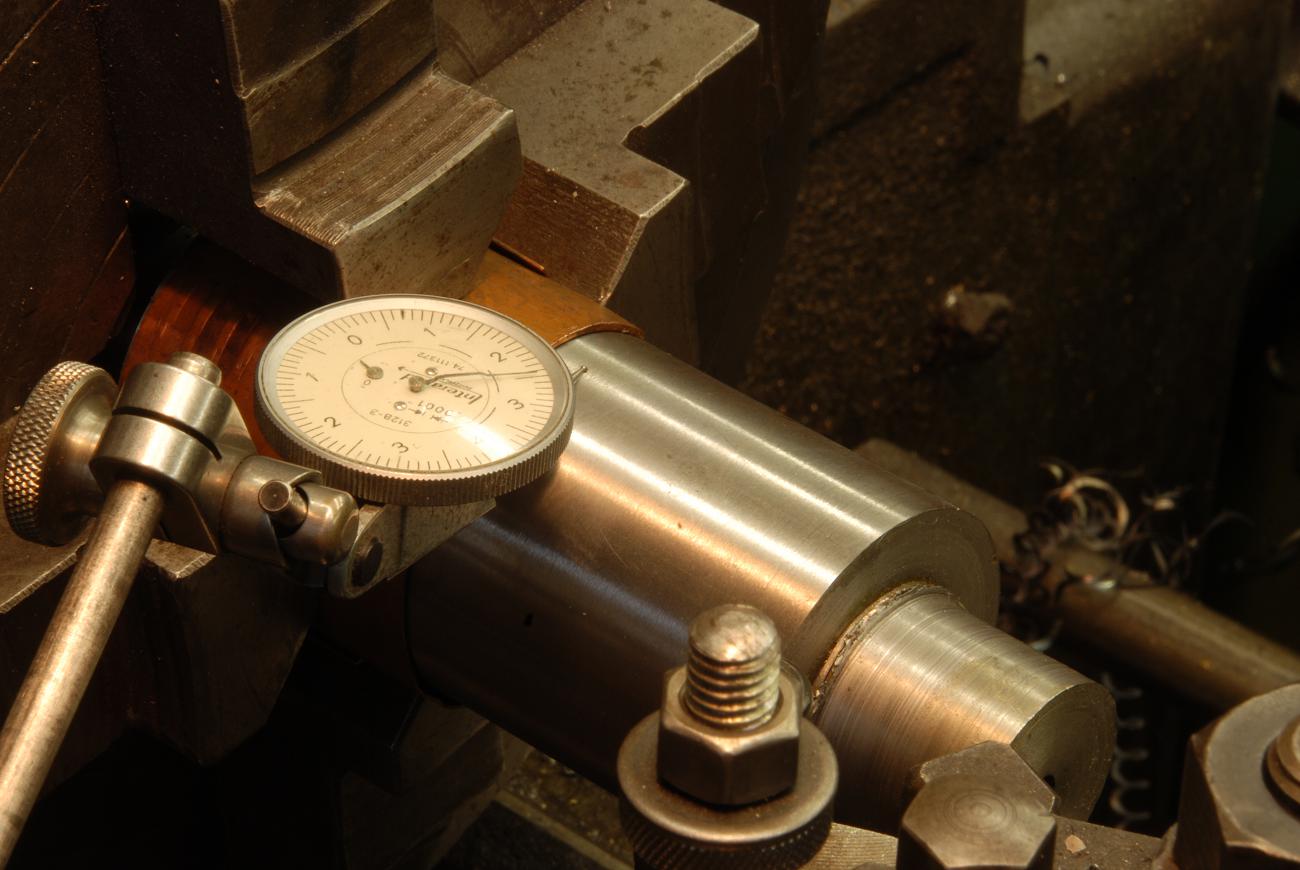

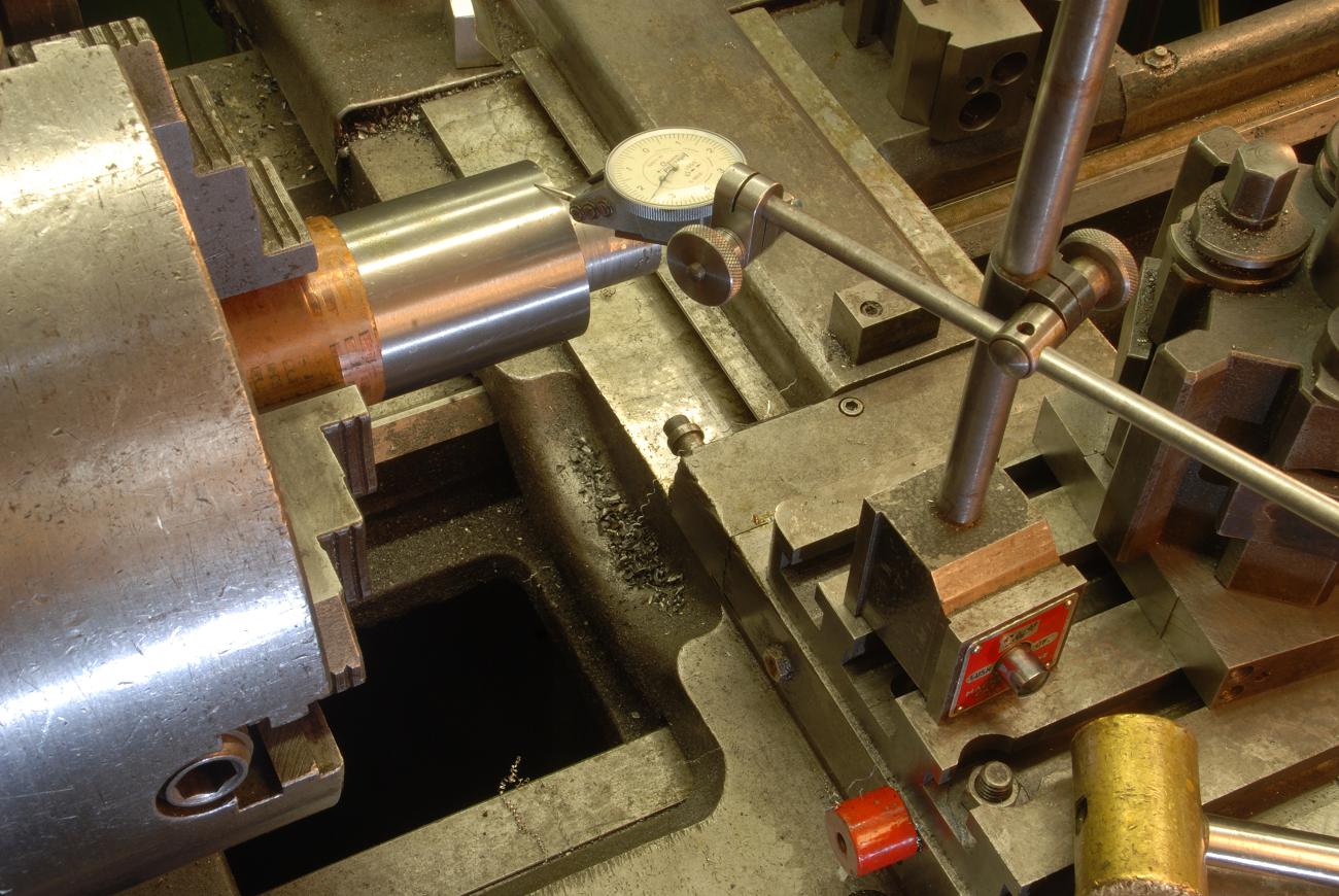

The key thing is to recognize is re-chucking repeatability. You can chuck a potato in a worn out 3J and it will turn a perfect round because its spinning about an axis against the cutting tool. But that's where it ends. If your 3J jaws / clamping repeatability is out say 0.003" which isn't unheard of, and you grip an absolutely perfectly ground cylindrical part, it will incorporate that same runout. Therefore turning the end or boring a hole of that perfect part will not be concentric to the OD. Every time you re-chuck its a new adventure. They do make adjustable backplate types of chucks & collet chucks to help with this but its a specific system.
A 4J (better to say 'independent jaw') chuck forces you to grip the part and dial it in simultaneously every time, typically with a test indicator on a surface so that it reads zero when its all tightened up. Now any secondary operation will be concentric because you have set it that way. And of course you can grip (non round) rectangular stock too but that's another thing.
What I think Susquatch is getting at, and I what tried to describe earlier, is that you cannot depend on the alignment, even with a high quality 4j chuck. You can indicate perfectly in one plane but unless you indicate in two, there will be wobble - i.e. work and lathe axis intersect where you indicated but are still not parallel. It'll be close with a good chuck, and good enough for lot of /most work, but it needs tweaking for exacting work.
For example, take something know to be round and straight to a high degree of accuracy. Say a cylindrical square (wrap it in something obviously to not mar the surface). Use your best tenths indicator and dial it in to the best of your ability, less than a tenth and barely a flicker of needle movement. Now, roll carriage out 3 or 4 inches and indicate. I can almost guarantee it will not be as concentric as it was at chuck. Photos below show what is meant by indicating in two planes - one close to the chuck the other further out. This is a spindle housing so bores for the bearings (expensive P4s!) need to be true - and each end needs to set up and bored. The only way to ensure those bores are aligned is reference the OD and indicate it in in two planes. Its a Rohm chuck so is good quality, but its still needs tweaking to get things spot on.
There are ways to to deal with it, and its somewhat of a pita and takes some time - basically iterations of dialing it in in each plane as well as judicial tapping.
I don't agree with the idea of the spider being for alignment, they're to discourage whip afaik, but the cat head can achieve perfect alignment. The one I have and have tried to use (and its a pita) is on a watchmakers lathe. making one is simple and a great trick if you don't have 4 jaw, but with a 4 ja just being for different lengths of work and only two are used at a time - hadn't thought of that!w I'd never bother with the thing. Susquatch makes a great point on the three screws;
Perfect compliment to my comments and spot on too! Along with nice photos to demonstrate.
Only one quibble. I replaced my factor rear spider with a custom made beauty. It is a joy to use when my work is long enough to be able to. The longer length make it easier to get excellent alignment. Alas, that is not always (or even often) possible, hence the joy of a good cats head.
