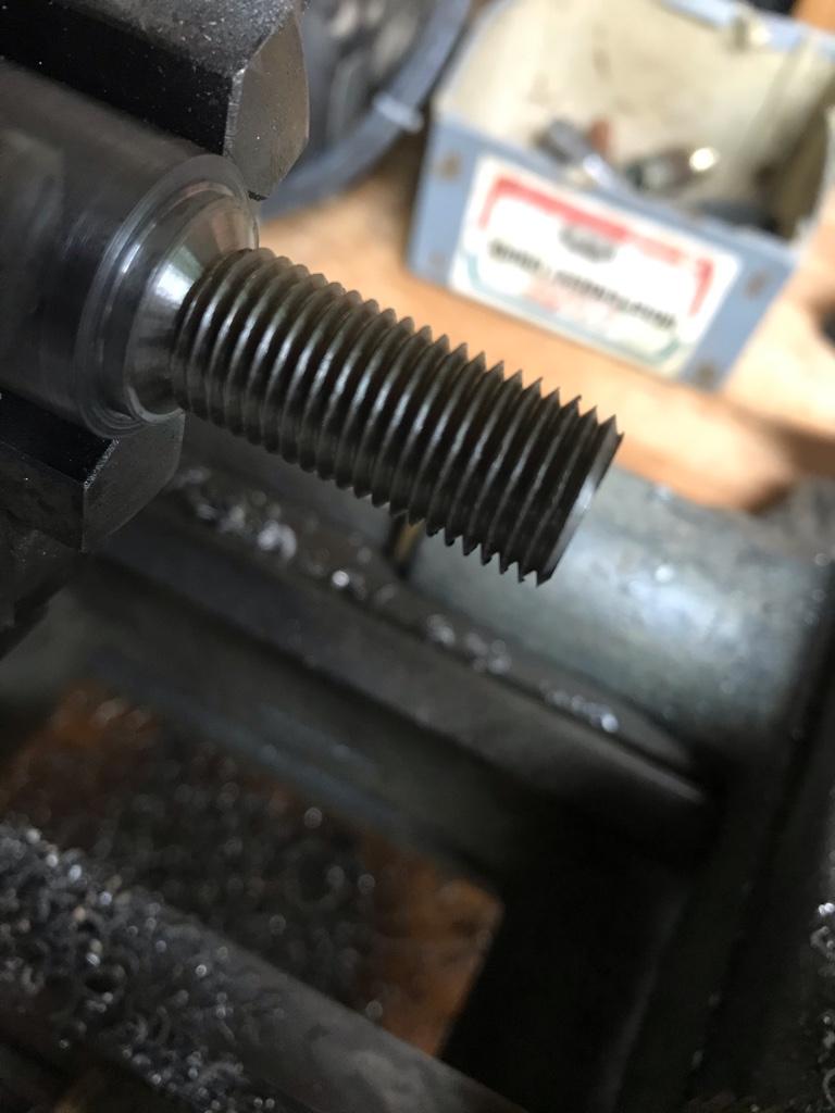

Wound down the day by practicing threading.
No particular diameter, just locking in the dance moves.

I know I didn’t go for an actual size but it cool to be able to shuffle through the moves.

I somehow put off threading far too long too. Still not an expert by any stretch, but its such a valuable asset.
You should cut a groove to end the threads that will give the cutter a place to stop before hitting the shaft.
@David_R8 - I like to use a parting tool and run it in to the theoretical minor diameter of the thread I am cutting. This serves 2 purposes - 1. gives me about 1/8" of run out space for the threading tool and 2: gives me a reference for the depth of cut. Typically do a trial fit of the nut about 10 thou or so before finished depth to check the fit.
At this point I will also take a file and remove any burs on the the thread tops such that my last couple passes will tend to clean off the remaining edge of the threads and ensures my test fit is for the treads and not the burs sticking up.
Your threads are looking great by the way - nice and clean - no chatter marks :)
Crikey I completely forgot about using my parting tool to cut the gutter...
What rpm are you turning at? And are you using HSS or insert?
What Brent said on parting tool. I either use my regular parting tools or you can even grind a round-over nose profile to give it a smoother transition vs. the 90-deg step (although a step can be chamfered so its whatever you prefer). Although threading tools can be plunged in like you are doing, they are really more intended for shallower depth of cut per pass. Chances are you spent some money or time on the profile, so its maybe good to preserve it for actual threading as much as possible.
