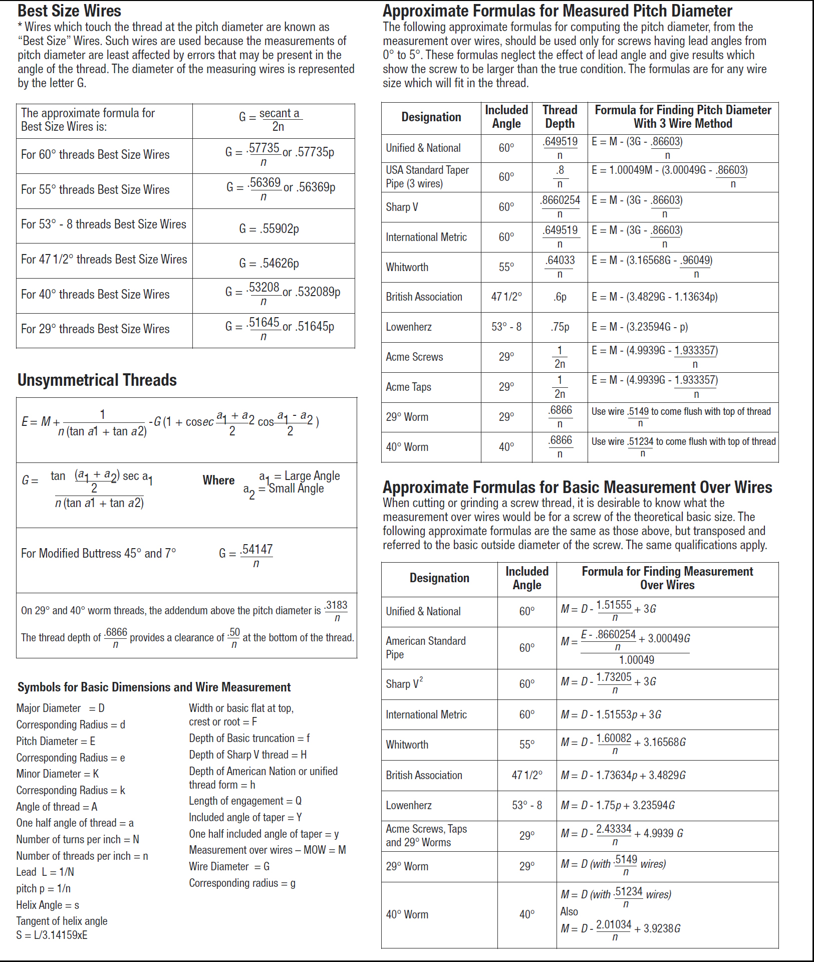

Simplest where possible is the mating part. That isn't always possible so the go to is thread wires. Cheap and cheerful and you can measure any thread with thread wires - its all based on pitch diameter which you can lookup in Machinery's Handbook. Sans combustible herbage ( :) ) the math isn't too difficult, you just work through the steps. First for choosing the best size wire, then you pick the closest one, secondly, using the wire, to measure and calculate the pitch diameter. As time goes by you pick up some thread mics making it quick and easy, at least for the profile you have the anvils for....... the thread wires still get used for the rest

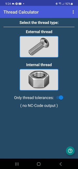

A good app is Thread Calculator. When you're at the home page, click on the "Only Thread Tolerances - No NC Output". They have every type of thread.
