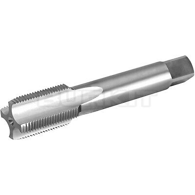

Diameter is 1.25 inch. Thread is 28 UN-2B. Pitch diameter: 1.2280 inch minimum; 1.2330 inch maximum.
Can someone help decipher this spec? maybe link a tap that would cut this if such a thing exists?

I couldn't fins 28UN taps at any of my usual sources for taps. Making one may be your best option.

If it's 28 pitch, I think I can just clean them up single point on the lathe carefully (not under power).
FYI to those who find this, single point worked...was quick, just pick up the thread and ran it through a couple times manually and they thread ok.
The bottom of the thread was just misformed, like they stopped feeding the threading tool while still turning, which is why the things would stop threading on as soon as they hit that spot but everything up to that point was fine...so I lost a half a turn of threads cleaning them out at the bottom, but zero impact on retainment of the microphone ball.
Problem solved :)
