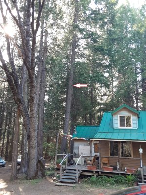

I'm not afraid to fell a tree, but I also recognize my limitations.
This one made me pucker just thinking about it, but it had to go.
Doug arrived at 7 am Sunday. I was still working on my first cup of coffee and scarcely had time to set the camera up.
He is 81 and quite deaf, but he sure knows his business.
It took less than 5 minutes from first cut to crash. He placed it in the only possible spot where it would do no damage. He then went on to drop 5 more, including a huge white fir that was 3-1/2' at the butt. He was here less than 1-1/2 hours, and that included a fair amount of conversation.
He'll be back later this week to jack over a big cedar behind the house.
Now I have months of limbing, brushing, bucking and splitting.
Wish I was as fast as he is.
Thanks for the video! Pretty cool to watch him at work. I can only imagine the calculations on mass, horizontal and vertical location of that mass, and who knows what other calculations are going through his mind when he is looking up. Wish we could watch the mental process as it plays out in real time.
Actually, that video does a great job of showing what he's thinking. Put the notch in, looked like he hit it with the axe to knock it out. Set his back cut height while he's by the notch. Went to the left to start the back cut. Set the wedge with a couple taps so it wouldn't pinch the bar, kept cutting and alternated driving the wedge. Left more hinge on the left to help pull it left. Once the wedge starts pushing it over grab the saw and time to move

Now I know nothing about dropping a tree, but I’m guessing the angles and cuts you are talking about are dependent on where the centre of mass for the tree is, and what direction it is leaning in already. I’ve seen a few videos where someone cuts the notch, figures out where they want a hinge, and then drops the tree on a house or truck. I imagine this is the same technique I would use - with similar results.
Sort of. General rule of thumb is the notch is the direction you want it to go. Which is what he did. The wedge might open up the back cut 1", but that might've moved the top mass 2-3 feet, so even though it's leaning slightly over the house it wants to fall into the notch. Him leaving more hinge on the left but very little on the right helps it "swing" and pull left to drop it in the hole. There was probably more branches/leafs/weight in the open area above the roof. If you watch he's very efficient, he does one thing at a time in a specific order.

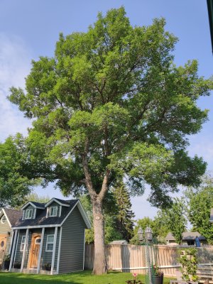

We have a 50 year-old ash in our backyard that is IMO priceless. To keep it in good health and make sure there wasn't any accidents with branches falling onto our buildings or our neighbors we decided to get it trimmed up. A team of 3, 2 in the tree and 1 on the ground, spent 2 solid hours trimming it. We paid $800 which included the clean-up.
Word of advice to anyone getting a tree trimmed by a contractor - make sure you ask about their methods of work and see if they mention sterilizing their tools between jobs. Had a co-worker lose a tree after he had it trimmed by a contractor. Unsterilized tools was believed to be the source of the disease.
Big tree, dropping went great, but I got very uncomfortable by how slowly he got through that back cut.....
I've got a big white pine that size hanging over my house that needs to come down. I might actually hire that one out......maybe....

Most ash trees in eastern Canada are doomed to die. The invasive Emerald Ash Borer is killing them by girdling them internally. The ministry is deliberately cutting them down to stop the spread. It is devastating to see entire woodlots deliberately flattened.
The ash borer looks like a small green grasshopper. Kill them on sight. I'm not sure if there is anything you can do other than cut down all the neighbouring ash trees.
You should be ok if it's a blue ash tree.
If you love the tree, I'd recommend some detailed research. By the time the borer arrives, it is too late. There are no ash trees left here. You have to stop it from getting there at all.

All this tree talk got me looking a little closer at the two ash trees on our property. I think I may have finally figured out the difference between the two. Back yard ash looks to be a green ash and the front looks to be a velvet ash. Always wondered why the timing of the leaves budding and falling between the 2 was about a month apart.
