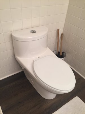

Well, good news I guess, returned the two flawed ones I had and went to a plumbing supply shop and got a "Cadet Pro" instead of the Home Depot "Cadet 3". Almost entirely the same toilet but the castings and glazing are good and a lot of what was plastic is now brass or other more durable materials. Cost $100ish more, but at least this one works, installed this evening:
