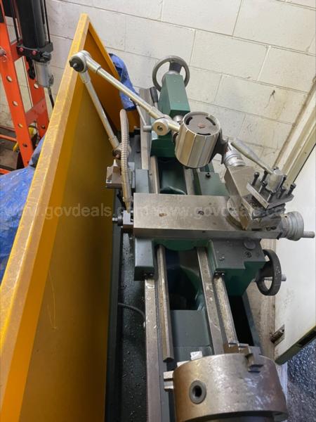

Also, on the GovDeals website you can see the reason we got such a good deal was that the lathe looked filthy. it could not be tested under power at all and the lathe was listed as not having any accessories.

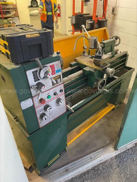

From the original sale site, covered in diesel exhaust soot:
Cleaned up as it sits at my brother's shop:
The backsplash is off to clean it and the rest of the lathe only, there is nothing wrong with it or the mounts for it.

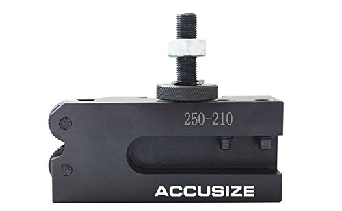

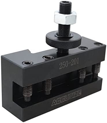

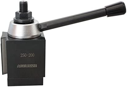

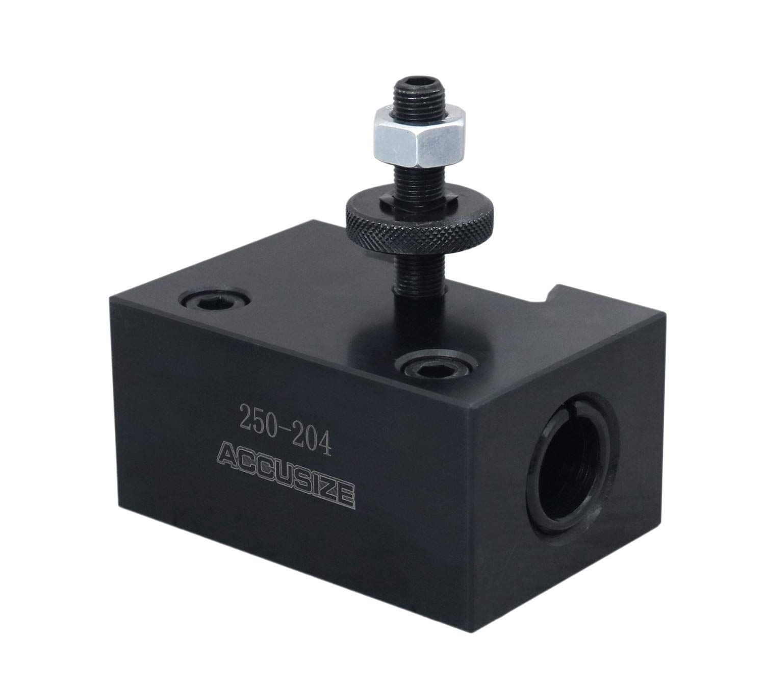

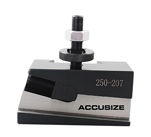

The next row down, outside jaws for the 3 jaw chuck, then the Accusize Industrial Tools BXA 6 pcs Piston Type Tool Post Set
comprised of 1 piece of each:
0250-0200 mounted on cross slide of the lathe,
0250-0201, 5/8" holder
0250-0202, looks just like 0201 also 5/8"
0250-0204, 7/8'' Heavy Duty Boring Bar Holder
0250-0207, Universal Parting Blade Holder Style 7 for 11/16 Blades
0250-0210, 5/8'' Knurling, Turning and Facing Quick Change Tool Holder

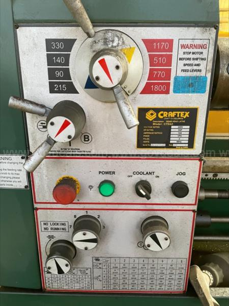

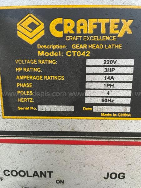

I'm sure that everyone here knows this already but the main specifications that make this a dream hobbyist's lathe are the 240 volt single phase 3 HP motor, the full flood coolant system AND the added safety of an emergency foot brake, and the D1-4 camlock chuck mount.
The swing over the bed is 14" while the swing over the cross slide is 8-5/8" and the swing over the 9-3/8" gap is a massive 20". if you're a steam enthusiast who want to turn big fly wheels this is a great choice for such projects. The distance between centers is of course a full 40". The spindle has a generous 1 1/2" thru hole, and MT5 taper.
This lathe has only a slightly larger footprint than the 12" x 36" belt drive lathe that we purchased it to replace, however at 1650 pounds this lathe weighs about 750 pounds more than the 902 pound 12" x 36" belt drive lathe. The extra weight translates to more rigidity and greater vibration dampening and the results in the quality of the work really showed when I made the new shaft for the variator of my Chipmaster lathe. For being almost double the weight this lathe is much easier to move due to better weight distribution and two built in lifting holes. It can be hoisted using any one ton capacity equipment.
