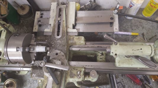

At the Calgary meet-up janger gifted me a taper attachment. This accessory came with his lathe but was unloved and unused.
Today I cut my first taper on my 9 inch Southbend (model c).
I made an adapter plate to go between the saddle (holes already drilled and tapped) and the traveler on the taper attachment. All six bolts go into their respective holes (no filing). The only mod to either lathe or attachment was to drill and tap a hole in the follower.
Thanks John it has been fun planning and happily it all worked out.
Gary
Ps excuse my lathe stand I know it's a mess but that is how I like it.
