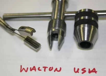

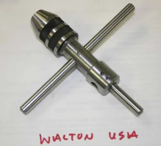

A USA Walton with removable pilot rod, non-ratcheting style. Notice the beefy jaws & jaw wire, nice overall fit & finish. The cone is nicely machined, runs smooth in the chuck, everything is chamfered & de-burred. Tommy bar is removable.

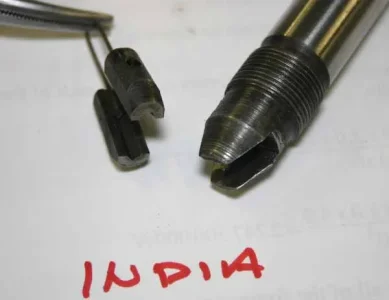

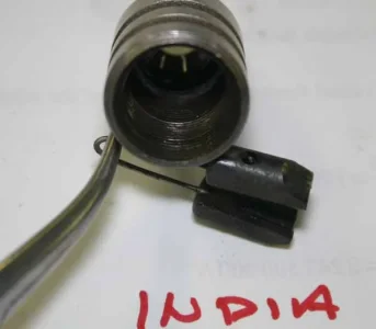

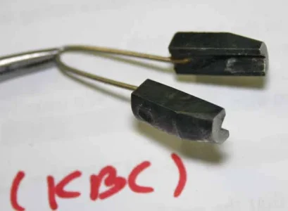

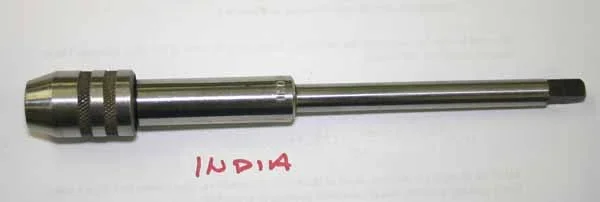

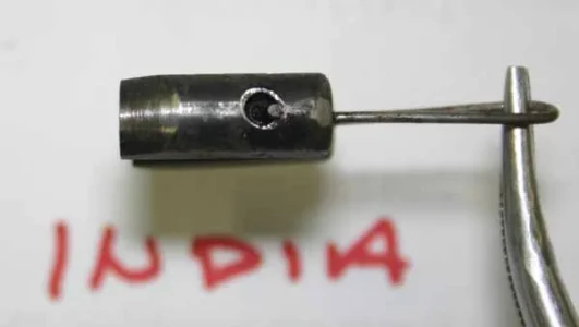

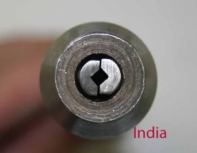

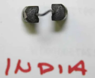

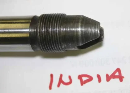

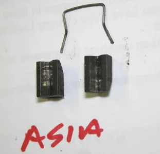

A long tap arbor from India (KBC), never actually uses. I had already cleaned it up a bit by this point. Pretty much everything is a tad rough around the edges. Not the best threading, really rough turning on the male cone, grips are unequal dimensions & don't fit the slot well, spring wire was bent at some off angle.

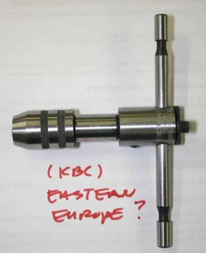

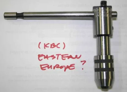

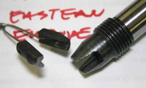

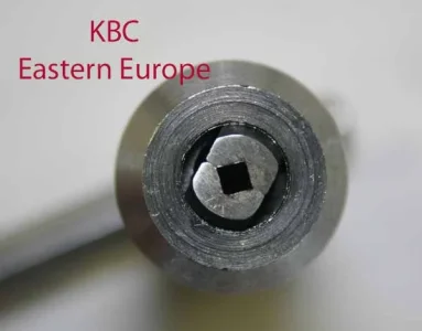

Ratcheting style tap handle from KBC, I think made in Eastern Europe, but not 100%. Overall pretty good quality. Big jaws, big spring wire. I'm not super fond of this kind of ratchet engagement on the top purely personal choice. Its kind of a pull pin & rotate/detent to lock forward, reverse or full lock.

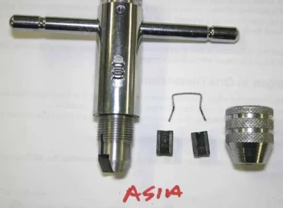

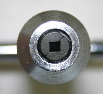

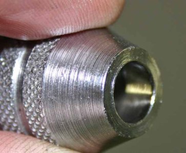

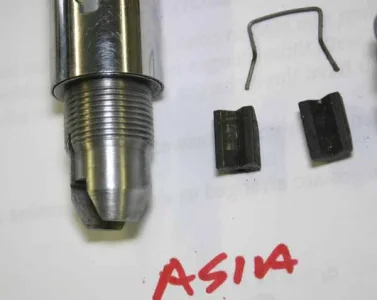

My old trusty ratchet model, probably 15-20 years old. It says Mastercraft (yes Canadian Tire). But don't take this as a Crappy Tire endorsement, they have shelves full of inferior junk too. I see this same design on Asian websites. The forward/reverse/lock lever is on the side of the body. the ratchet itself is quite fine & smooth. I heard it was a German or Austrian design that was farmed out to Taiwan back in the day but this could be BS. I see similar ones now from Ali/Ebay/China but don't know its the same or clone of clone. The spring wire is kind of teeny & jaws are a bit shorter but I haven't had any issues. The male cone is machined nice & particularly so is the mating female surface in the chuck.
