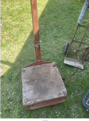

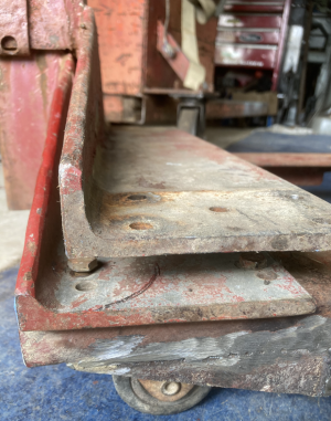

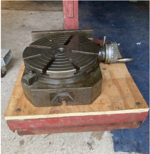

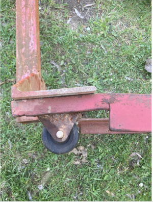

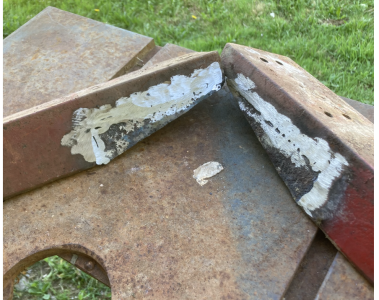

Hello gang.
I am getting into conditions when lifting heavy items is a real pain for my back. I was looking trough internet for some ideas and inspirations and there are few youtube folks that have build "sky hook crane". Tubalcane has several videos with great explanations of his ideas and considerations and I decided that I need something similar for the dividing head, vise, lathe chuck and other heavy items that I have. I browsed trough my pile of metal scrap and found few pieces that might be suitable for building table top crane without whole lot of manufacturing. Main objectives are simplicity, safety and use of what I might already have in hand.
Here are part that will be used: Car shock absorber, spring and spring plate removed, steel plate (brownish colour) that will be mounted on the mill table or lathe, boom (extra parts need to be cut off) . Still missing flange to affix shock absorber on plate, boom support, trailer winch. Any thoughts ?
