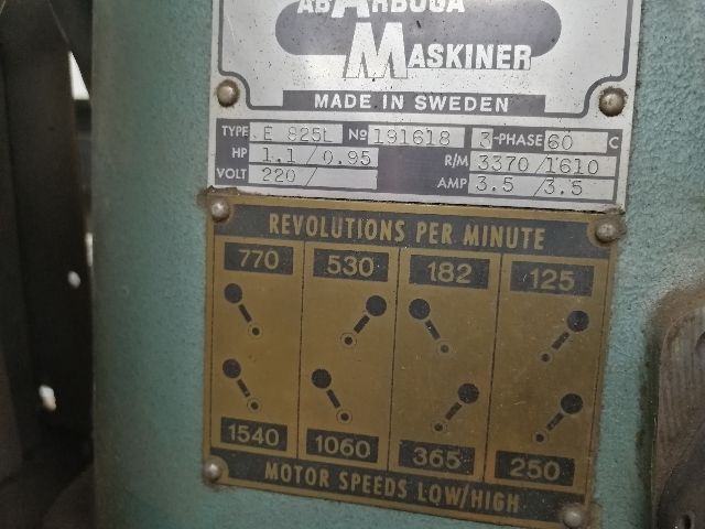

I got this drill press in the package deal of my machines.
Has gear box speed controls.
The motor is internal and had unexplained “issues” not sure what or why.
The millwright whom I bought it from had the idea to mount a motor on the top mounting the input gear from the original rotor.
Drill head moves up &down on the post also. Has a MT 2(???) quill.
Solid machine for sure, I don’t have the space or the time to take on another project without risking a nervous breakdown (still trying to get my lathe going)

Motor almost certainly was 3 phase and maybe hi/lo 2 speed originally. Rewinding the motor would be very expensive. I have an Swedish Arboga gear head drill press, but the original motor was mounted on top so was fairly easy to change motors. Great drill presses and very powerful at the low speeds. John
Motor almost certainly was 3 phase and maybe hi/lo 2 speed originally. Rewinding the motor would be very expensive. John
not sure about the 3 phase there’s no data plate unfortunately, there are 6 leads on the windings. Hi/lo for sure, looking on line there is actually a decent amount of info including a ‘restoration’ on YouTube even. Pics have a switch on the head, I’ll have to look through the box of extra stuff I got to see if it’s in there.
One of the three circles on top of the phill dress (in pics) lines up with the input shaft. I have a face mount motor the guy figured could be mounted externally to run it.

That is a nice drill press. Have you taken it to a motor shop? It would be worth getting a quote...maybe be expensive or you might be surprised. the 7.5 hp motor on my DSG went and I was having trouble finding the same form factor replacement and was pleasantly surprised when the rewind was quite a bit less than a new motor. If the rewind was $500 say and the rest of drill in good shape, that would be a heck of a deal.

I have same machine (well color is a bit different) same gear box, same handle etc. Motor is 3ph 2 speed. I assume its 240v (220) but it could be also 480 (440). or even 600 (550).
Mine is MT3.
