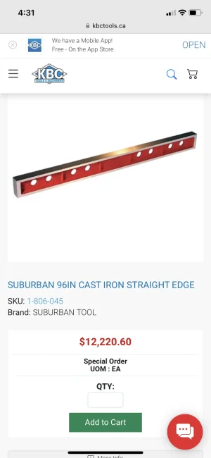

Industrial straight edge. It’s a good idea but…there is a wee problem.

McMaster has a 96” aluminum version for $196usd. Still expensive. I think susquatch suggestion of Lee valley is a good one.

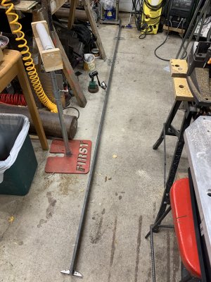

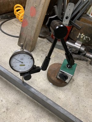

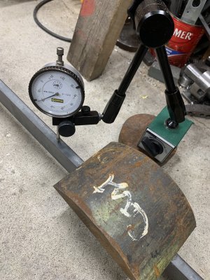

I did a test out of interest. I found a 10’ 2”x1/2” bar stock. Supported it between two drops. Then I put my test indicator on it in the middle and pressed on it with my fingers. It moved 0.05”. With a 3kg weight it moves 0.020”. 1/32” is 0.031” for comparison.
Everything is rubber even a really awkward straight edge. If this bar was something that could be heat treated how flexible would it be after? @Dabbler have you got an equation and some constants for different materials to see the math?
The nomenclature gets a bit muddled in that the references flats a scraper uses, e.g. a camel back, are also commonly called straight edges. I think that is a crappy handle....."reference flat" would be more descriptive and appropriate imo. Nevertheless if you search for straight edge you'll see a lot of what are what I call reference flats... which are likely going to be more expensive and perhaps not what you are after. I've got reference flats (camel backs) up to 60" (I can barely lift it) and a 72" Starrett straight edge (still waiting for its first application) I picked up somewhere along the way but for wood working I'd reach for a track saw track thinking it would be good enough.
