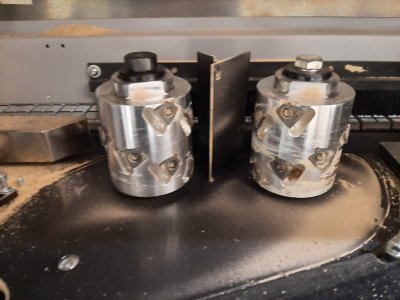

So at work I have an edge banding machine that applies pvc or abs edging to pre-cut plywood panels. It has a pre milling feature that mills off whatever thickness of edging you are applying. Normally 3mm. They were starting to get dull. They are diamond PCD inserts, which I have gotten three years of steady cutting.
Called my supplier. $92.00 each. I need 24 inserts in the cutter head. Almost $2200.00.
I ordered them, but. My question is , at home I have a cutter grinder / surface grinder (KO Lee ). What type of grinding wheel would touch these inserts up? I see online you can ship your entire cutter head and have them sharpened. So they must make a wheel to do it.
I would make a fixture to hold the insert and just lightly do a grind So they are all the same. I have the diamond cup wheels here for carbide sharpening would they work?
Martin
S+1 to @TheCNCNerd sharpening PCD inserts requires very large pressures with diamond tooling that I think is outside the range of most hobby machine shops.
The Diamond wheels are about the only thing that will touch a PCD insert. I tried it on an older grinder and found the wheel would climb rather than cut and had to put some down pressure on it. the results were less than optimal.
here is a link I had in my bookmarks. http://www.superabrasivetools.com/grinding-pcd-tools-and-sharpening-pcd-tools/
good luck.
