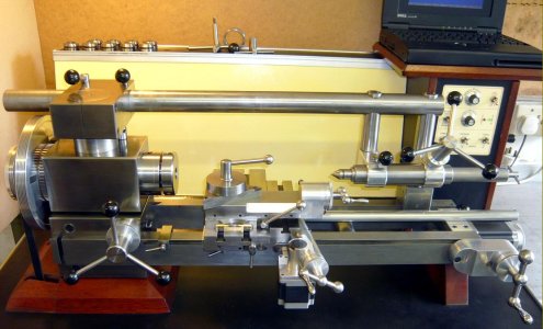

Beautiful work. Why does the tail stock have that support bar from the headstock?
Hi John, the reason for the overhead support bar is that it is part of the tailstock.The spindle and tailstock can be moved vertically, enabling the headstock to be used as a small milling machine with the cross slideacting as a milling table.

Check out all those pictures everybody in the link post #3 from David. There are 4 pages of description and many more photos showing the multitude of operations showing this machines capabilities. There is a lot more to that machine than just a lathe! Wow.

Thank you for your kind comments. As to what I would change, during covid lockdrown, I had a go at redesign etc and I posted this in the Model Engineers Workshop Mag. I attach this here.
As to manufacture etc I did consider this but it is a big undertaking and at my age (83) I dought it would be a result I would see the end of. I would just be performing in another undertaking so to speak
