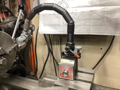

As part of a purchase last summer I was given a faulty Starrett Flex-O-Post & 657 mag base on the offside chance I could repair it. The issue is that when the lever at the base of the flex post is rotated to it's furthest extent, the post does not stiffen. There is still slack in it.
Anyone ever come across this before? Solutions?
I don't have one of those, but a buddy does. I put a thin washer in the stack. Problem gone.

I think that Starrett model has a tension cable which likeley stretches over time, or loosens on tensioning spindle, or whatever. So a spacer washer may well do the trick. I've heard this is somewhat common, they don't seem to last over time or QC went south at some point. If you have no/low $ into it, nothing to loose. The articulating arm style like Noga or Fisso have solid rods with hardened anvils, much better system.

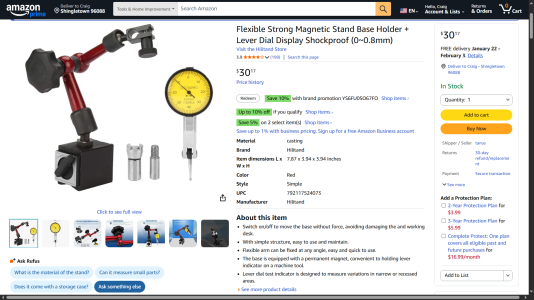

Generically known as a "donkey dick", I have the (original?) Flexbar version. They are generally unreliable for use with indicators, even when functioning "properly". To tighten the cable, loosen the locknut at the top end and screw the indicator clamp mechanism out (or turn the barrel nut under the locknut, I forget), then re-tighten the locknut. At least that's how mine works. Once I bought a Chinese knock-off Noga ($30 with DTI), I found a more appropriate use for the Flexbar.
The faux Noga is the most rigid indicator holder I've ever used. But then I've never used a genuine Noga.

Needs Viagra. Yeah i know how it’s supposed to adjust tension.
The on/off button requires some SERIOUS pressure to move.
Even when on, it doesn’t have near the magnet the cheap knock-offs have.
Looks like the name plate needs the rivets removed (how?) to clean out the guts & free up the movement & maybe the magnet.

If I had to guess and I do, that nut at the top not only locks the position of the indicator holder, but also tensions the said cable.
Perhaps they unscrew themselves from the eye or plate that runs on the eccentric of the clamp lever?
