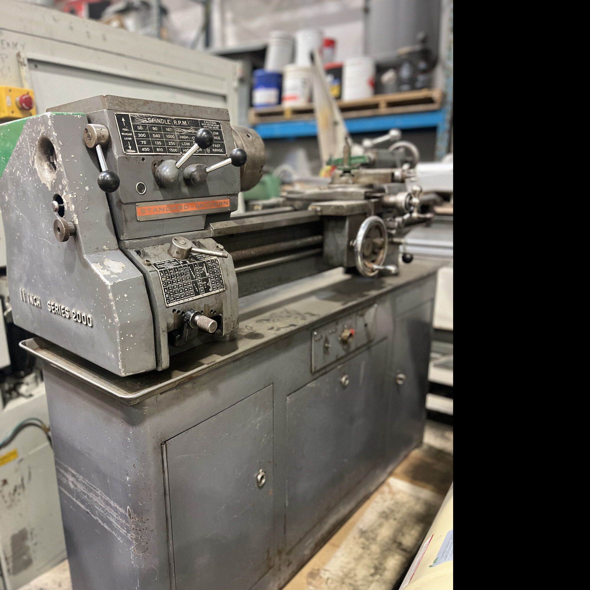

Got a line on one of these and went and looked at it. Comes with a bunch of tooling and centers and a qctp and a homemade steady….
3 and 4 jaw Pratt chuck…
No follow or taper attachment.
4000$ was his bottom dollar.
Opinions? Thought? Buy? Pass?

How familiar are you with lathes?
What is your impression of the overall condition?
Did you go thru all the gears? Is the headstock quiet or does it rattle little old jimmy?
Will they let you take the top off the headstock to check the gears?
Page two of the manual says what was standard with the machine, how much of it is there?
Did you run the carriage all the way left/right? If you just snug up the carriage stop when close to the chuck and run it to the right how much does it tighten up?
In today's market, depending on where you are, if it runs well and will do what you want/need then it's probably not a bad deal, not a steal or gloat by any means but okay.

Not super familiar. I’m used to Cnc plasma, 3D printing, and some mill stuff. Don’t know a whole lot about lathes other then reading.
My general impression of the thing was that it’s in good shape. I inspected the ways and tested most of the gears and everything works good. Power feed works good. Doesn’t look very used. Oil was lower then sight glass and didn’t have the wrench to open the headstock, but I could go back and do that I’m sure. Gears not inside the headstock looked in great shape. Everything felt tight but smooth.
I’ll post pics. I don’t really like the fact it doesn’t thread metric…. But I want a lathe and getting used ones is difficult.
Not sure what to think about it.

I did run the it to the ends of all the travels and it all feels snug and smooth. Runs quiet. No clicks or rattles. I’m not sure where the carriage stop is on this one though. There doesn’t seem to be a lever for it. Do you guys know?

You can set that up to cut metric threads. That lathe will have an Imperial thread on the lead screw (very common). You would need to acquire the mechanical conversion gear (usually 127 tooth gear), then work out what gearing selection on the quick change box is need, perhaps some other back end change gears (likely others have already figured it out). An Imperial lathe which can “thread metric” has simply already had those details worked out for you.
I have two Imperial lathes that can thread metric, one has the mechanical conversion gear available on a leaver (though it still misses a couple common metric threads, I need change gears to get all common metric threads). The second lathe I have to swap in change gears and follow the chart in the manual to select the qc gears in order to get the correct metric pitch.
I also have a SM 11 LD (looks just like the 12 LD in your photos), I have not specifically looked into what gearing is needed for metric threading - perhaps others here on the forum have?

There is a carriage lock over on the RH side of the carriage. A carriage stop that bolts to the bed is something one could make. There is probably an official SM carriage stop that could be purchased as an extra. The manual shows a micrometer carriage stop. The manual also shows a “metric transposing gear”.

This all depends on where you are. It is an old lathe. It is a 12 x 30.
You can get this brand new machine for just 4500 CAD -
it is 12 x 28 - its a bit small all around but it has almost certainly bigger bore and no issues with threading metric. You would need to make a stand for it.
You can always get my "old" lathe - https://www.busybeetools.com/products/metal-lathe-600mm-with-stand.html
This is also 4600 - like 6 years ago it was exactly half that price (!!!)
Comes with a stand, it is generally forum liked machine BUT it has change gears for threading - its a bit of a pain.
If you were in Calgary I may have soon for sale almost brand new 11x 26 (modern tool) with all accessories and stand for just 2500.
So based on all this I think price of 4000 without almost any tooling beyond standard stuff is too much.
Heck in Calgary a modern lathes that were I believe 14 x 40 sold for around $5000 and I would gladly upgrade to these machines over this 12x36 - which is OLD and smaller for just 1000 extra. And I was saying that $5000 is not exactly a deal for them either (they were 20 year old).

The line pointed at - is that scoring? The circled area where the tail stock slides looks rather poor?
I have all the conversion details to convert to metric for these lathes. There is a yoke assembly that fits to the gearbox and a couple gears required- i drew a bunch of stuff up in CAD from military manuals and looking at other lathes that had been converted.
My Miss metric Utilathe has a metric lead screw and the feed screws are metric as well. All are dimensions Imperial however. - like a 7/8” x 4 mm pitch or 1/2” x 2.5 mm pitch.
The gear conversion is a bit more complicated but probably the easiest after machining the parts is done. You just need to change gears.
I would put the Utilathes 10/12 and the older 11/13 in about the $1500 to $3000 category (condition dependant) - additional tooling like taper attachment, follow and Steady rests would add more value -
Same for a lot of additional tooling and chucks.
You need to make your own parts or break the bank if you source new (they make you the part custom) so it is important to make sure things are working properly and gears are running smoothly. Best indicator is the smallest gear - run at 50 RPM and see how noisy things are. This gear is machined into the drive shaft and probably runs the most often.
Older transition models went from set screw adjusted gibs to taper gibs - some times a mix on the cross and compound feeds.

They were significantly better made than today's offshore stuff, however whether it is still better depends on condition. In other words it might of started off better, but is it still? I'm doubting it. Brent has spotted some interesting stuff. It really does come down to condition/wear as to whether that is really overpriced or a great deal. Brent is also in Ontario where the livin's easy, and the lathes are cheap :)
20 years btw is nothing for lathe, if was well cared for and constantly lubricated.
As for parts, what parts? I've reconditioned several lathes, have a dozen and fixed and sold more.....never once have parts been an issue (unless one busts castings, but who does that?). There is just very little that isn't fairly easy to make or a commercial item. Its easy to be wrong making generalizations, but that has been my experience.
Me, I'd keeping looking. They are a great lathe, but I'd rather pay more for one in amazing shape with lots of tooling or a small fraction of that and recondition it (remove the wear). But you're they guy ground who can assess condition and wear.
Almost certainly it is the wear mark - it is a used tool - it has wear. Lathes are consumables - same as any other tool - or say a car. Sure you can renew a lathe by scraping it in - new ways --- same as you can rebuild and engine - but it seems its not done too often these days.

Thanks for the input guys. You guys know a heck of a lot more about it then I do. Ya, If it was cheaper ide probably hop on it but for slightly more I could’ve got a 1440 with available parts….. maybe if he comes down on price….. it probably would be a good lathe though. Valid input from all around.
