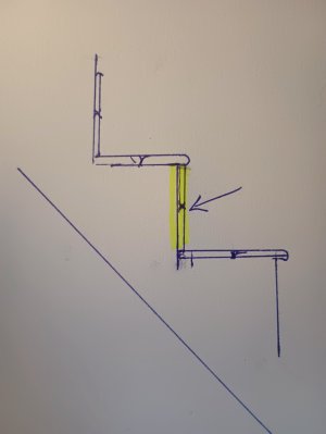

Based on common sense, I'm pretty sure I know the answer to this question, but I will ask anyway.
Staircase with stringers 16" on center.
Am I correct to assume the risers are not relied on or even required for that matter WRT the structural requirements of the staircase?
That's not to say they wouldn't make the staircase more solid.
The reason I'm asking is that the Trex material provided for the risers is thinner than the original cedar risers and while tall enough to fill the gap, is shorter than the original risers such that it will not be tall enough to be loaded top to bottom as the original cedar risers were.
As @phaxtris says, not required. But I think they are a good idea.
When you drop something on a stairway, it always ends up rolling behind the stairs and you gotta go make love to some spiders to retrieve it. No fun at all. They have this nasty habit of eating their lovers.
I've also seen people trip on a step somehow and get a leg caught on the backside with nasty consequences.
I prefer the risers. They don't have to be Trex. Paint them! Do a mural! In fact, paint some hungry spiders on them! But no, they are not required.
