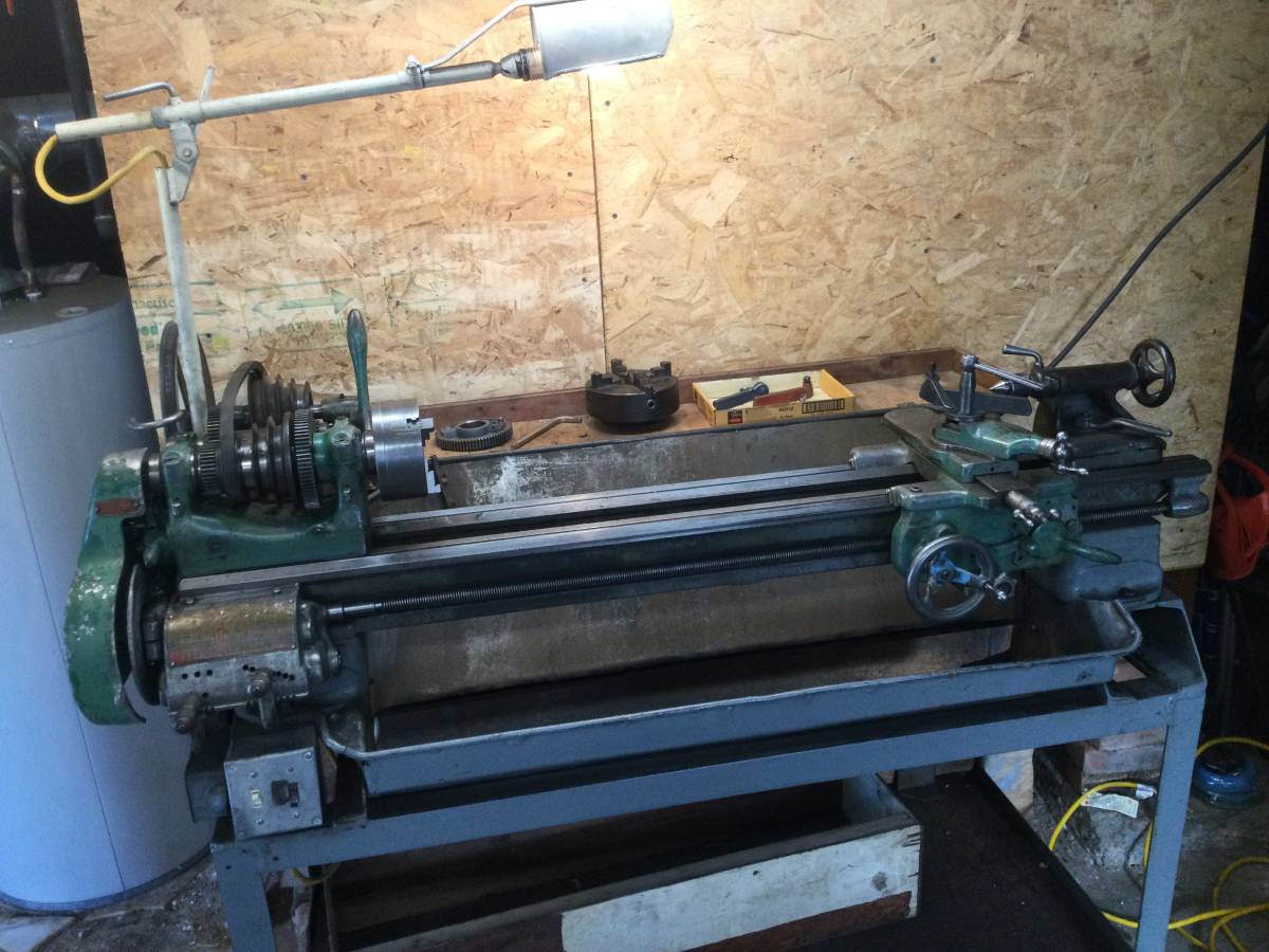

New to old hobby machines. Can you tell me if that has a powered cross feed ? From what I’ve read it looks like it. Can someone confirm that for me. I’m fairly new to this forum but love to read it and the humor on it.
Thanks.
Thanks.
It looks like it does have as it has the two-position lever to switch from longitudinal feed to cross feed.
Screenshot 2023-10-02 at 14-58-51 00R0R_l9LkpSFqLgA_0CI0t2_1200x900.jpg (JPEG Image 1200 × 900...png
The star wheel in the center/bottom of the apron engages the clutch for the crossfeed.
