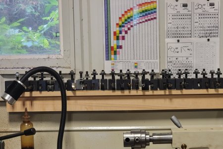

I keep wanting to make more that way for myself. It would be nice just to be able to say I did it... but I don't REALLY need more.
That's about 2/3 of what I have. Ya, I don't need any more......
