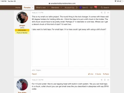

Another pic problem? This is what the iPad brings up.
now I can touch it and it brings it up in the usual display but still doesn’t load on the page.

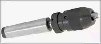

You can get smallish chucks like shown. Some go under the name 'precision' although that's debatable. You might be able to find a clone inexpensively. The trick is finding or making an arbor that fits the internal taper of chuck & suspect you want straight for the tool holder?
