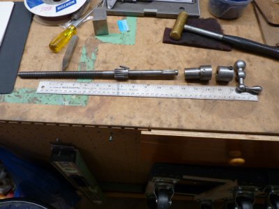

I wanted to make a new screw not only because the lathe needed one but it was to add to my knowledge and experience.

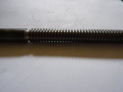

I used .500 C1144 steel for the screw, it turned really smooth and the only surprise was how much better the steel is than the cheap cold rolled I used for practice.
The thread is a LH 10tpi acme so there was a bit of a learning curve, using a straight 90* plunge with the cross slide only worked well. The first .030 was cut in .005 increments, the next .020 was in .002 increments and then finished in .001 increments with a few of spring passes spread out in between.

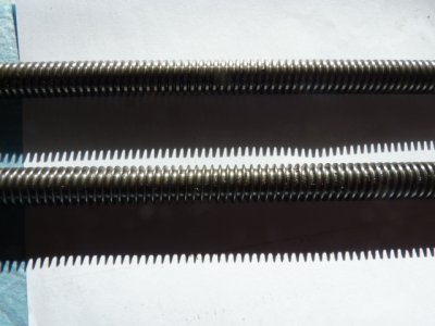

Drilled the hole for the gear roll pin, milled the flat for the set screws and installed. Were there was .100+ movement with the old screw, there is only about .004 of movement.
The first pic shows the components of the screw.
The second pic shows the cut of the thread.
The third pic show the new and the old screw, the shadow really shows how much the original screw is worn.
All in all it was a great learning experience with lots of help form the clan here on the site, thanks all.

The difference in the shadows is remarkable.

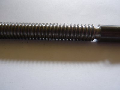

The threads in the nut look the same, sharp enough to cut yourself.
This was the second attempt, on the first try I miss stepped dancing the dials and ended up with one side of thread looking okay and the other side at about a 45* angle, oops.
