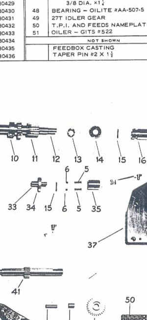

Is it possible to adjust the clutch on the feed shaft? I can make it slip a bit more easily than I feel ok with. The manual doesn't say, but I know a few of you, such as @Brent H and @RobinHood have been into this model deeper than I have.
It does feel like they may be worn, which would be odd based on the overall great condition of the lathe. I guess i'm going to have to pull it apart. On my Emco, the clutch is easily adjustable, and I was hoping for the same on this lathe.
I concur with @Brent H ’s assessment of the possible cause of the clutch slipping.
The detents can be reworked to improve their functionality. One option is to go to the next size bigger ball bearings (even just going with metric ones, slightly bigger) can help a lot once their pockets are cleaned / re-machined.
