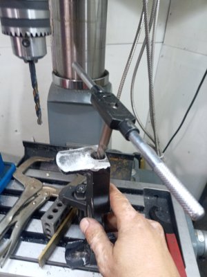

First thing, extract the broken studs....normally I just weld a nut on and pop she's out...but they are to far down the hole...easy out time...those never go well
I manage to get them out, next up...I should address the wollered out holes....what what I suspect the reason the bolts broke... lack of support

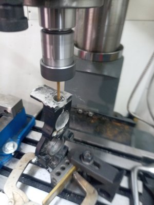

So the drilling setup was no where near rigid enough for milling...time to figure something new
Yep that worked, the holes are as large as I dare make them...not perfect, but serviceable

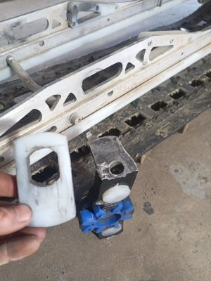

I figure the bolt will probably move so it needs some kind of Shim...the pictures I can find it looks like brass...I don't have brass that big...but I do have delrin....IMG_20220918_184557_850.jpg
All of the pieces
And test...I'm not bolting everything up for good yet, I still need some extra thick fender washers (ordered), 2 grade 8 bolts, and a piece of uhmw to make the missing side shim (the white piece in the first pic)
