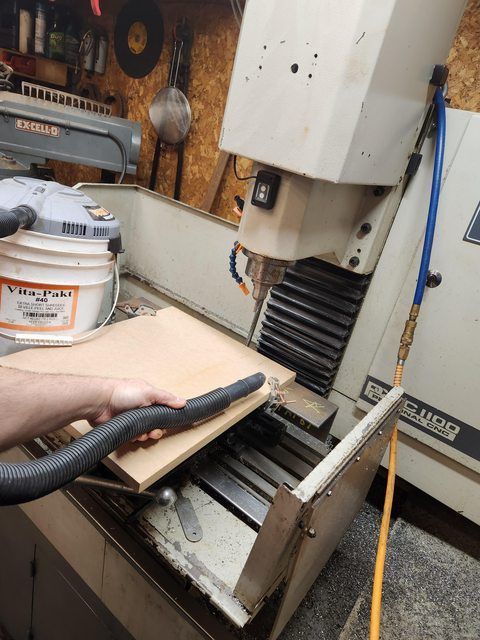

I use an ancient Ridgid shop vacuum sucking through a DustDeputy cyclone separator on a 5-gal bucket to attempt to keep swarf -- mostly aluminum with some plastic -- under control. This mostly works but the vacuum doesn't have sufficient "suck" to pickup balls of fine swarf or clumps of the curly stuff and ensure that it gets through the hose. I think that a more powerful shop vac may solve the problem but I'm unsure of how to choose. The adverts claim "6HP peak" (but drawing 10amps so unlikely) and other nonsense. Since everything is trapped by the DustDeputy I don't need a large container on the vacuum.
Recommendations?
Does anyone use a BusyBee or similar dust collector on metal bits?

My rigid works fine for everything but big clumps and very long swarf.
Rather than HP of the vacuum consider increasing the velocity of the airflow. Think of tornados, larger objects need greater wind velocity to move in order to overcome their inertia.
Decreasing a section of hose while maintaining the same airflow volume increases the velocity of the airstream.
This is why nozzles come with vacuums.

a cyclone between the dust collector and the nozzle prevents anything getting tangled in the blower.
dust collector fans have sufficient static pressure to serve the same purpose, but the hose dimension needs to decrease to increase the velocity.
that said, for metal swarf I prefer a vacuum, a cyclonic separator and a 15 gallon blue polyethylene barrel. They can be tapped to drain off waste oil... and are not too heavy when about 1/3 full of swarf.

I use an older Rigid 5 HP vacuum that has a fairly small container. It uses a paper element filter to stop dust from going through the blower and motor. I was wash and dry the elements and reuse them. Best to do that in the summer when you can leave them out in the sun to dry. I made my own cyclone bucket from 5 gallon plastic pail with a snap on lid. Just used some ABS plumbing fittings through the lid of the bucket to match up with my vacuum hoses. I had to buy a second vacuum hose for the input to the bucket. Works fairly well at sucking up swarf, but does plug once in while. The 2nd hose has screw on end fittings so it is fairly easy to deal with a plug up.
I use a big one just like yours to clean the shop.
I use it's smaller brother for swarf. It has a smaller diameter hose which helps keep the velocity up to pick up steel chips and suck them out from under a vise. I made my own hose nozzle that fits the T-Slots and gets into tight spots better.
Has a 5hp (claimed) motor and really does do a great job on small swarf. I manually put the big swarf in two big garbage cans (one for steel & one for aluminium) and take it to the scrap yard. I don't get much for it, but at least I know it really does get recycled. Stainless, cast iron, brass, & copper go in smaller 5 gallon pails.

kstrauss
Well-Known Member
Thanks for everyone's comments! To clarify a few points:
I mostly use a nozzle with an oval end that just goes into the T-slots on the hose. The nozzle probably increases the flow rate but is also a problem -- clumps of swarf blocks the end of the nozzle.
My cyclone does a very good job of dropping the chips into the 5-gal bucket. Almost nothing makes it to the vacuum so its filter is not an issue.
