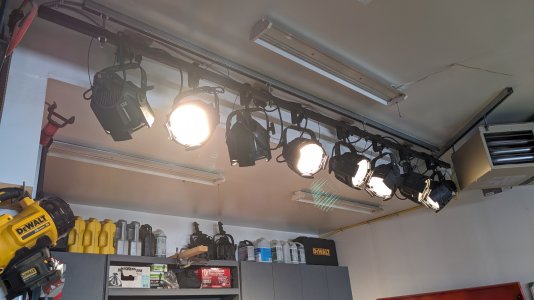

I came across a bunch of used ETC Source 4 Par's for $15/each, these used to be $400ish stage lights. I picked up 10 of them and hung 8 in the garage, wired in four new circuits for them as they're a bit power hungry. Ironically, it cost me more to rig/wire them than the lights themselves cost. They're 575 watts each, though can also take a 750 watt lamp, all HPL style lamps. It's completely pointless, given I already have 8 of the 4500 lumen 48" shop lights (you can see a few in the picture) which is plenty bright, but this was fun for shits and giggles. They're also rather nice in the winter, standing at the bench with four of them shining on me gives me a nice warm back from the heat radiating off these things without even turning on the heater :) cost to run all eight works out to something like 50 cents per hour depending on time of day.

How many of these lights on on a single circuit? According to the Canadian Electrical Code you should only have one per circuit, as you are only allowed 1200 watts per 15 Amp circuit. If you have 20A circuit breaker then you are allowed 2 lights, but the wire involed will have to be 12/2 gauge not the normal 14/2 gauge in residential housing. 15 A breaker = 1200 watts = 14/2 wire, 20A breaker = 2400 watt - 12/2 wire.
There are two lights per circuit. I put in four 15 amp circuits, using tied 15a breakers (Siemens Q215 - 2 x 15a) into two sets of 14/3 wire, and then did 4 switches (switch each of the hots red and black individually), and into split plugs so each outlet is connected to both red/black for one of the two receptacles in the plug. There are two plugs (4 receptacles) per 14/3 run, 8 receptacles total.
Loading is 575 * 2 = 1150 watts per circuit with two lights. But you're wrong about the limit on a 15a circuit, code calls for no more than 80% planned loading which is 1440 watts (120*15=1800*0.8=1440). Technically running 750w bulbs would be close on a 15a circuit, but 83% would be perfectly fine and isn't my planned load anyway so meets code. Same reason why we can plug a vacuum or hair dryer or space heater in which are more than 1440 watts.
All of this meets electrical code.
