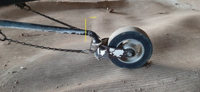

The plane is a "taildragger", small wheel on the back instead of the front. Originally, the tailwheel only pivots side to side a bit. It is connected to the rudder via cables and springs so that when taxiing, directional control is via the rudder pedals and differential braking. But if you need to push the plane backwards, ie, put it into the hangar, or do a 180 degree turn on the spot, the limited rotation of the rear wheel hinders that. A common upgrade is to replace the tailwheel mechanism with a fully rotational one.
It is a kit available from 3rd parties. It requires cutting off of the bar (tail spring) and installing a new tail wheel bracket.
Soooo, the question is...after cutting the spring, I need to put it in the lathe and turn it to fit the new bracket. But it is tapered. The only way I can think of keeping it firm in the chuck is to play around with shims. Or use the spider at the left end of the spindle, if the spring is long enough. Is one of these the way? I included a photo of my tailwheel and the instructions with the kit.

You could machine 3 or 4 shims depending on the chuck you want to use with an opposing taper so that the jaws of your chuck see a nice flat surface and get a nice clamp
Might need some kind of collar to prevent the machining forces from pushing the taper out of the shims
Or carefully drill centers and turn btwn centers
Those are my thoughts

machine your own tapered or even stepped collet , or tapered sleeve with a draw bolt arrangement?
Janger
(John)
One way is with soft jaws for the chuck often made of aluminum. You machine the jaws to fit the taper.

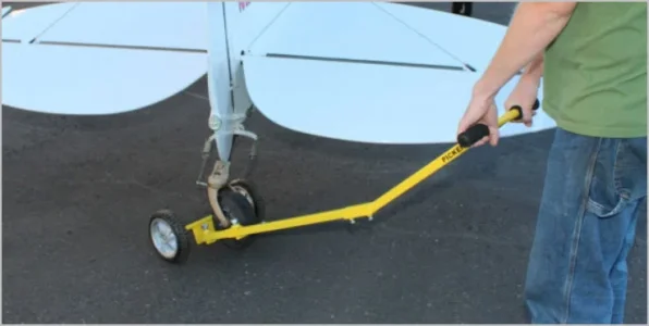

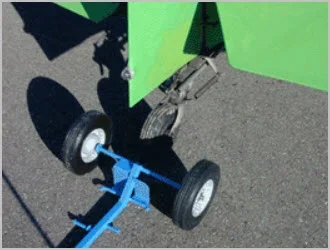

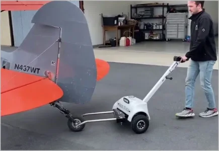

I'm not a full size plane nut, but there seem to be many examples of some kind of captive 'shoe' assembly that the tailwheel assembly fits into for this kind of moving around purpose. Most have a pivoting dolly/skate type rotation axis to make it maneuverable. Could you come up with a simpler/lighter duty version similar to these to save cutting into your gear? Not sure if the gear tubing alloy or shape is special in terms of providing the right amount of spring & control, but another consideration.
I might be looking at something like this for in and out of the hangar if I want to use a lawn tractor as a tug. But the mod I am doing is mostly an upgrade for maneuvering the plane while taxiing it. So while in the plane.

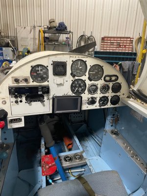

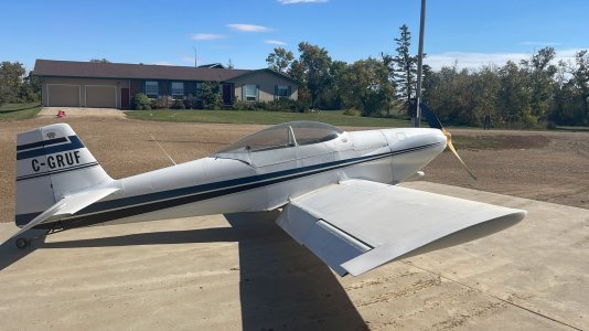

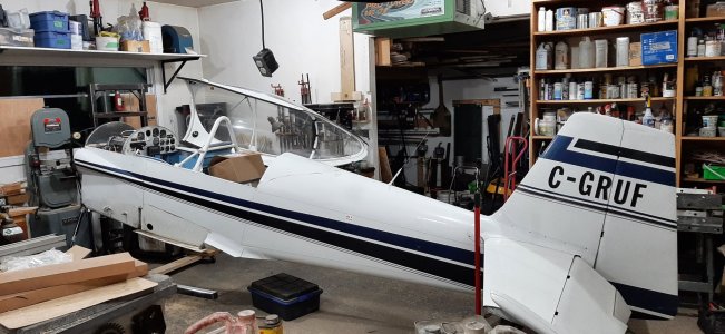

These photos are from this summer. Plans are to replace the entire panel, add lights, redo the engine, and just general cleanup. Make it purty, ...

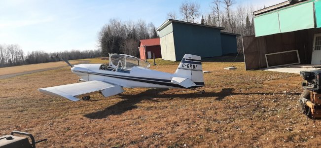

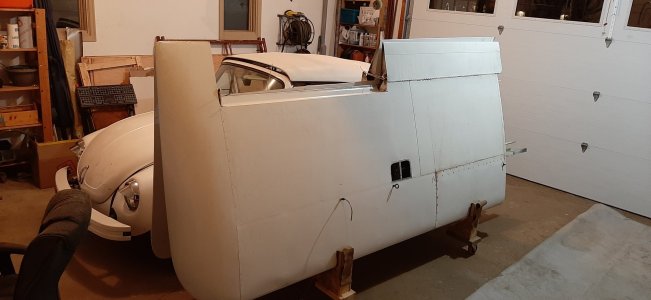

Here are photos taken today. Let the fun begin. I had to order new tools, and buy a new rolling bench, ....we all agree that all renos justify new tools, right?....Shhhhh!!
