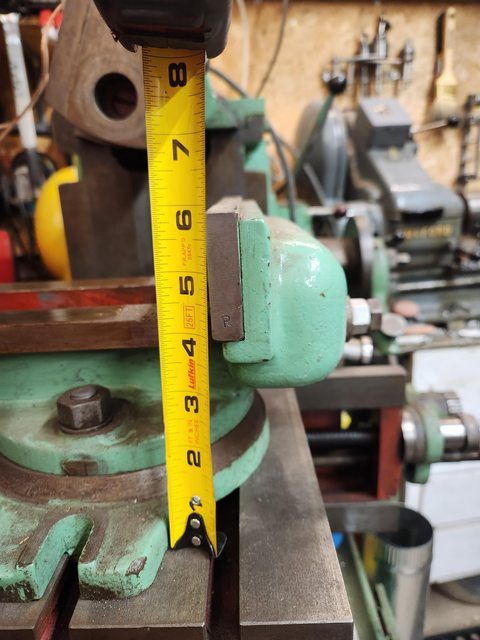

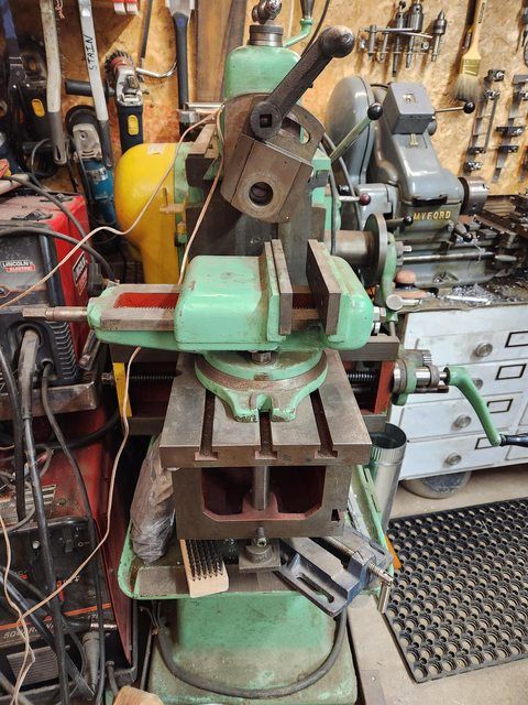

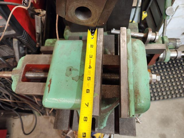

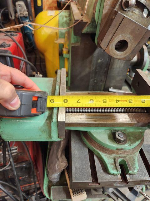

Here's the vise on my 13" Prema. As for why I wouldn't want it bigger, I feel it's big enough to handle any larger workpieces, but not too big itself that it takes away machine capacity. Anything bigger would just eat up more real estate that is already squeezed.
That's 6" to the top of jaw, and 4.25" to the bed. On a machine with 13" travels, that's giving up a lot just for workholding.
Hope that helps a bit.

Thanks for your input, the loss of vertical space makes a lot of sense as to why one wouldn't want a taller vise. This 14" vise looks to be about 7.5" to the top of the jaws with the swivel.
