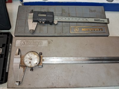

One of the items in my estate sale purchase was an older Mitutoyo dial caliper. It is in rough shape, but it caught my attention.
I'm looking for some parts for it. 141700 hook, 141771 roller, 141776 crystal, and a 141769 stop slide.

I did manage to scoop a couple nice older digital calipers also. They cleaned up pretty nice.
I know what your saying about the used price of the dial calipers. :( Your post did get me thinking...... "unless you can make the parts".....not sure why I didn't think of that.....I can probably 3D print the hook and the slide stop. Crystal shouldn't be a hard thing for me to find.

Of course that old 6" Mitutoyo is nice, but it is so old they hadn't invented battery covers yet. You have to unscrew the case to change the battery. I'm ok with battery changes. These are so much nicer then my Mastercraft units. I have a vernier with no markings on it I bought back in the day....maybe BusyBee. I still pretty impressed by that one. (Doesn't take much to make me happy.)
