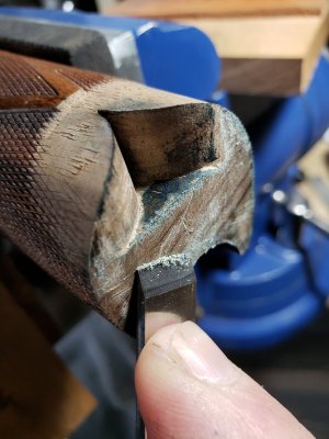

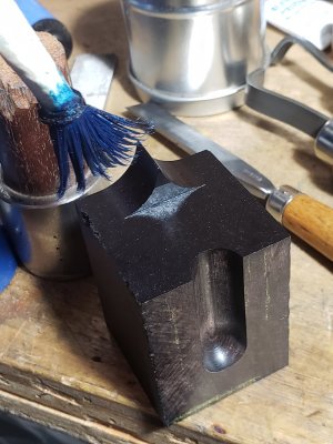

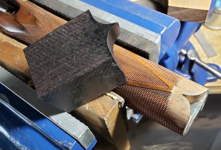

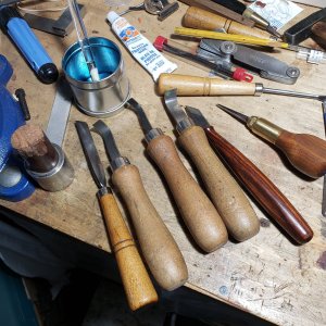

Not scraping metal, but wood. I need to epoxy two dissimilar types of wood together. The one part is flat, the other has a feature that has to be inlet into the first part. Just like scraping two metal parts for contact, but instead of a surface plate and roller, I sparingly blot a blue dye onto the piece with the feature, put the two pieces together, and the blue dye gets scraped, or chiseled or filed away, from where it has marked the flat piece. Repeat a gazillion times until you have a perfect fit. The trick is to use very little dye, and to know how much you can rough out before going gentle.

@thestelster I'm a long time epoxy sniffer, mainly for RC work but other applications too. Just curious, what kind do you use for work like this?
Hi Peter, I usually use West System G/Flex 650. I also use J.B. Weld. The longer the cure time=stronger the bond. In my case here, I will also include mechanical strengthening of the joint, such as dowel pin, stainless threaded bolt, small holes in both parts so that the epoxy flows into.
I used to use dental marking paper for this back when I was doing such things. Very fast to use. Put the transfer film in, push the parts together, pull apart, and sand or Dremel. (ya, a gazzilion times) There used to also be a special bright yellow wood marking fluid you could use that would not stain the wood. I prolly still have some, but it's been years since I did anything like that so I'm not really sure where it is.
