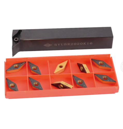

I know absolutely nothing about inserts and what best to use. I know I tend to chip them quite easily. Not sure why.
What tool holder uses these?
Are inserts for Aluminum or steel?
And to add to my question:
This looks to be the type of tool holder and the same part number inserts. Is it just larger and meant for deeper cuts?
Is there a chart somewhere to be able to decide what sort of inserts to use and why?

You might not have a choice. One manufacturer cannot produce all the variations, it would be in the millions! Sandvik for instance, for their positive inserts, have 7° and 11°, and the 11° is for small diameter internal turning.

I'd love to find a one-size-fits-all document that helps one choose the right insert. I've had my best success just sticking to a few choices of carbide inserts and tooling for roughing out different types of jobs just because it's so convenient and then switching to hand ground HSS for the final finish. I know that isn't what most others do, but it works for me.
What strikes me funniest about all this is that I know you are a very detailed complicated technical fellow - you have to be to have done all that old microprocessor s100 stuff. And so am I. But for some reason this insert complexity is beyond me. It seems like we are always hopelessly looking for the perfect grain of sand on the beach. Maybe we are just missing some very simple detail that would turn the light bulb on for us. I don't know, I keep looking.
I chip my carbide pretty easily too. I just swap them out and keep going.
If I could find something somewhere that gave solid advice on the most common, most cost effective, most useful inserts and insert tooling for various materials and job types, I'd be a happy camper. The trouble is that I find it to be a rats nest of infinite variety. And it's not just the inserts, it's the insert tool bars too!

The problem isn't only knowing what the shape of a carbide insert looks like. The what to use and when and how that is for me more difficult.
For example:
Say I've cast something from 356 al ingots and I want to use the 1.25" diameter sprue for something. So I clean up the edges and chuck it in the 3-jaw, face off and drill for the center on the tailstock. Also turn the rough edges off and bring the 1" protruding down to 1.125" so it's round.
Flip it around, face off and drill with center drill. Then clamp the round part in the 3-jaw and support the other end at the tail stock. Now turn the rest down to 1.000".
Simple right?
What spindle RPM and what feed rate? Normally if I'm roughing I'm doing about 0.010" to 0.025" per rev. If I want a really nice finish I'll drop it to 0.003" per rev.
So three things are needed.
1a. Roughing what tip radius?
1b. Finishing at 0.003" per rev what tip radius.
2. What spindle RPM?
3. What depth of cut.
The third is a big issue. HSS can handle a very small depth of cut. I've read that Carbide needs at least 0.010" to 'bite' into the metal and not just 'rub'. That may not be true of the smaller inserts but where is that information?

It all appears to be guesswork which is what I have trouble with. But I still don't know what top rake and back rake I need or even tip radius for a specific carbide insert.
Years ago I met an old machinist no retired but a close friend. He started with speed & feed rates well beyond what is recommended and achieved fantastic finishes on the most difficult materials. Cooling is the key. This is how I got into ionic synthetic coolants (even on my old Logan lathe).
Now Titans of CNC has been doing the same thing.
These feed charts well are a starting point. Experiment and find what works best for your setup and machine. The following will happen.
1. You will get better results.
2. Most of your feeds will be higher, faster and more aggressive.
3. You won't trust charts any more.
This is why I don't share my set ups anymore. It is geared strictly for mine.
Remember all of these things are dependent on, cutter toughness, sharpness, material shear, HP, Torque, machine rigidity, work hold, vibration control, feed speed ability, cutter hold and application.
Ditch your charts, experiment, go by feel, you be a better machinist for it.

I don't accept the premise that the information manufacturers provide is useless. Manufacturers use expertise and science to produce better and better technology. It just takes us mere mortals a little longer to understand and tap into the knowledge and technology they create.
Perhaps that's part of the problem. Just when we think we are catching on, along comes another advancement. To make it all more difficult, each company is in competition with the others and they are not all equal. The choices get a little overwhelming.
Another problem is the market the insert folks are after. It only makes sense that they target the high volume outfits who can benefit from fine tuning their processes. The typical hobbiest makes one-offs, has limited opportunity to experiment, and wants a good result each time. Nor can we afford a tool shelf full of the latest and greatest to play with.
For my part, I just want to know what works most of the time, what is affordable, what is readily available, and the basic rules for using it to get good quality results. Sort of a tried and true approach. That was the basic intent of my thread "what inserts do you like.... ".
I reasoned that most of the members probably had favorites for the low volume hobbiest kind of work we do.
For my lathe I use these and I have extra boring bars from 6mm diameter to 12mm diameter that hold these inserts. Some of them are profiled specifically for aluminum. I don't remember (and it's not marked) what the ones in the red box are for.
Actually the red box does say what the parameters are: VP15TF is a Mitsubishi carbide insert designation : http://www.mitsubishicarbide.com/application/files/7214/4643/8968/b034g.pdf. It is for a variety steels, not aluminum.
