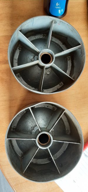

A friend of mine has a 6" belt sander. I don't have any photos of it, These are the wheels. He asked if I could fix them. They are dented. I started to straighten them last night but realized if they are white metal or similar, I might break them. A magnet does not stick to them but they seem heavier than what I would expect aluminum to be.
These two wheels run on a common shaft, and are the idler end.
Any suggestions on how to proceed?

Depending on the cost of the sander, I favour #1. You can probably reuse the bushings. Solid aluminium wheels with weight reduction holes in a pattern would make you a hero.
Even if you can manage to straighten them, the yield strength of the metal has been exceeded and they have yielded. It will never be the same again.
Yes it can be repaired (same as AL wheels), gentle (forceful) pressure and heat (how much don't know the answer but they use a propane torch).
Now if you are doing this as a helpful but learn exercise great, otherwise turn a new wheel.

If they are 'white metal' - a euphemism for "whatever was in the pot that melts at XXX degrees" typically is very high in zinc content, and might not like heat bending. I'd be tempted to epoxy fill and turn it to round again.
I was going to suggest the same but add that you might need to add some epoxy to opposite side to maintain balance if using quite a lot or if it's very high speed.

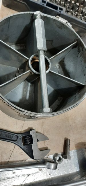

Here is what I came up with. The wheels are now better, but far from perfect. I took an -thread rod coupler and a couple of bolts and used them as internal jacks. I took a large gear clamp and wrapped the exterior of the wheel with that, with a piece of 18 gauge steel inserted between the clamp and the wheel, opposite the dent I wanted to push out. I was hoping this would cause the greater force to be concentrated on the opposite side from the steel plate. It actually worked fairly well but I also noticed that I could easily cause a separation between the internal web supporting the wheel so a compromise had to be made. I did this on all of the major dents and I could note an improvement. But there are also some high spots, probably as a result of the low spots...? When I decided I had pushed my luck enough, I put some gorilla tape on some of the low spots and then put one wrap around the two wheels. I don't know why they are made as two parts so perhaps taping them together will not work. But by doing this, I was able to find the positions relative to each other where the differences are not as dramatic. We will see if it stands up.
I did warn my friend that to pursue it may cause the wheels to break and he was ok with that. I figured I can still be more aggressive in the future if this "bandaid" does not make the sander usable.

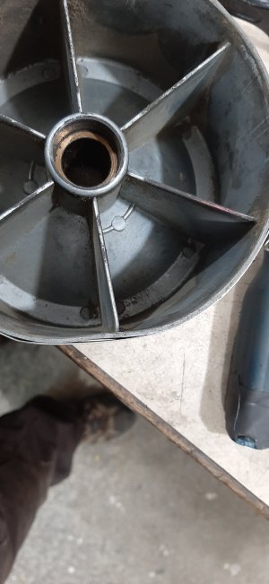

Judging by the gates inside the wheels, these look to me like they were diecast. Zamak, maybe? If so, a VERY small amount of heat from a torch will leave you with a puddle!
If they are Zamak, I don't think there is a recognized "best method" of repairing dents. Most stories seem to end with 'and then a big chunk broke off'.
